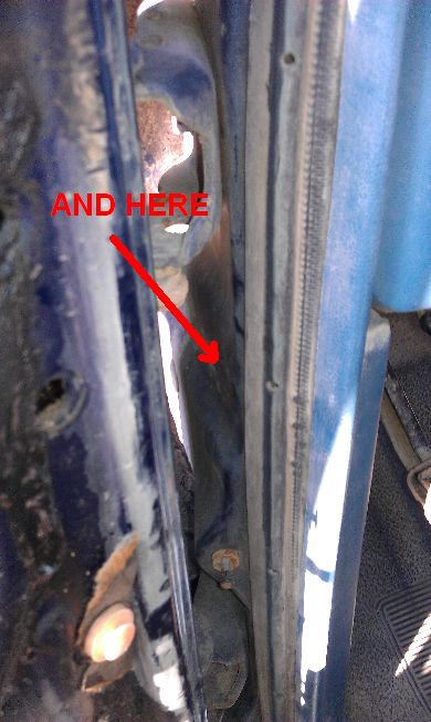

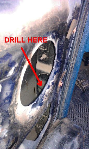

Do you happen to have any pics of where the factory holes are? I'm planning on drilling
(Name:  X2xJU.jpg
Size:  53.0 KB) there and
(Name:  qEkgK.jpg
there, spraying on a little primer, run some wraparound plastic conduit, and go from there. Is this a stupid idea?

I think you're in the right neighborhood....here's where mine are. Not the factory wires but I believe it the factory hole

Go to a junk yard and get the rubber boots that run from the door to the cab and measure where they are. You can use from 80-97 parts, they are the same
Old Mar 20, 2012 | 09:01 PM
Dave804's Avatar
Dave804
Joined: Jan 2012
Posts: 3,462
From: Richmond
Yep, Head to radioshack or a junk yard and get the rubber. Go to a newer, but cheaper car. Higher odds of getting rubber with some life left in it, but the less wire to the doors, the more likely it'll be round. Go to the back doors if need be.
You want the holes to be at the same height, so drill in the door, then close it and mark the frame.

Any of the '87+ trucks will work too for the rubber looms. The doors and jambs should have a dimple in them from the factory locating the center of the holes - at least that's what I've been seeing on them.
