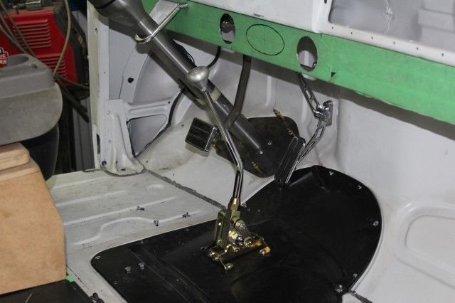

The steering column is an aftermarket unit from CPP. 30" column shift with tilt. I don't know if the shifter lever at the bottom is supposed to go thru the floorboard or stay in the cab. Plus I'm trying to decide if my drop down bracket drops down far enough. I guess I won't know until I have my seats installed and see how it feels.

That shifter fork should com off I believe so you can slide it through the floor opening. Do you have a picture of the other end?

Here is the lower end.

Is that screws or rivets I see on the bottom plate.? It's hard to see but looks like socket head screws, you'll be able to remove the shifter fork then re install it after you put the column through the floor..

Sorry. Here's another pic with light.

You can remove that piece and index it where you need to to hook up your linkage..

That'll work.
How low should the drop down go below the dash? Mine feels like it holds the column too straight up.Name:  D576B74F-8336-47DF-B070-44714A2CDA32_zpsrdcj3b0h.jpg

I did mine different on this build, I used a 4" drop and bolted it to my dash extension. On my panel I used a 2" drop but the column on it went through the firewall just above that floor opening because of the frame swap I did on it. You might be better waiting until you get your seats at the height that is comfortable for you and decide from there. In the Midfifty catalog they say a 4" drop is usually the norm but everyone is different..
