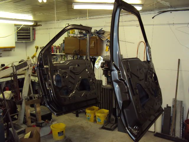

Little more progress this weekend. Did the body work on the doors Sat, Primed and wet sanded sunday and sprayed yesterday
I also had my brother help me get the cab back on the truck.
Windshield guy came too
Hopefully hang the doors today

I have a couple questions. What did you use to bond the new rockers in? Do you just cut out the old one's?
Old Feb 22, 2012 | 02:15 PM
  #51
Diesel_Brad's Avatar
Diesel_Brad
Joined: May 2009
Posts: 21,437
Likes: 76
From: Gilbert, PA
I used 3m panel bonding adhesive to bond the new rockers on. For cutting them off, I drilled out the spotwelds.
Doors are on and the glass is all in

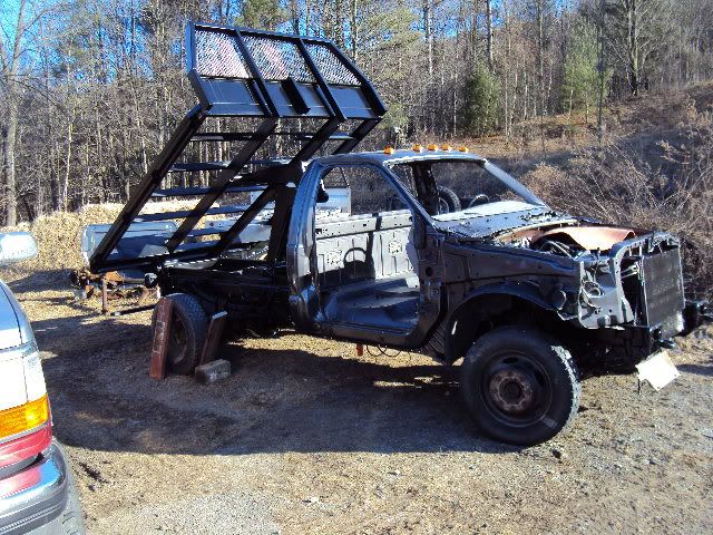

Like this one?
Old Feb 23, 2012 | 09:38 AM
  #54
Boss08v10's Avatar
Boss08v10
Joined: Jun 2009
Posts: 663
From: Elk River, MN
Yes, but with a tricked out flat bed and taller stance.

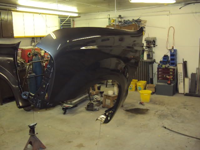

Finished the body work and primed the hood and fenders today. Should be able to wet sand and Paint tomorrow. Gotta see If I can find another sound deadner for the hood, mine is ratty
Old Feb 25, 2012 | 03:10 PM
  #56
Diesel_Brad
Joined: May 2009
Posts: 21,437
Likes: 76
From: Gilbert, PA
Got the fenders and Hood painted this afternoon. I did get a little carried away with the clear and got a run in edge of the one fender, but It should sand out. But now at least the painting is done.
