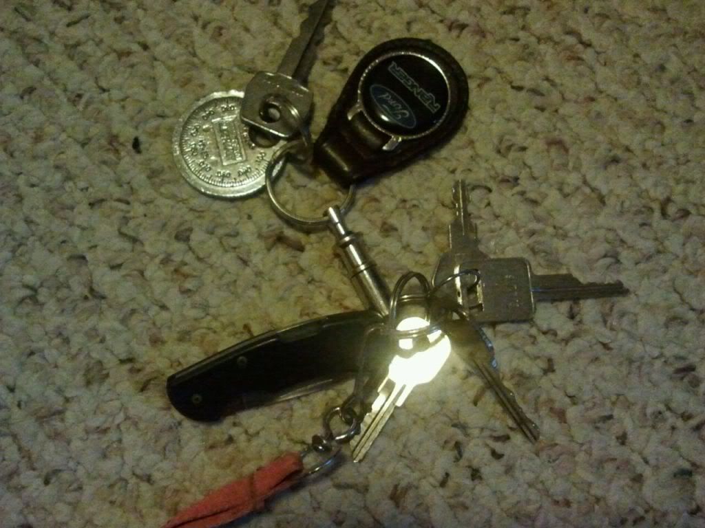

Like i said i only got 5 keys on mine, all for my own things:
I also got a tiny knife for my personal protection and a keychain thingy from when i had my ranger. Then i have the detachable link so i can separate truck from the rest and my NOS lanyard so i can go fast. The spark plug thing is from the PO and i figured i don't have one might as well keep it.
