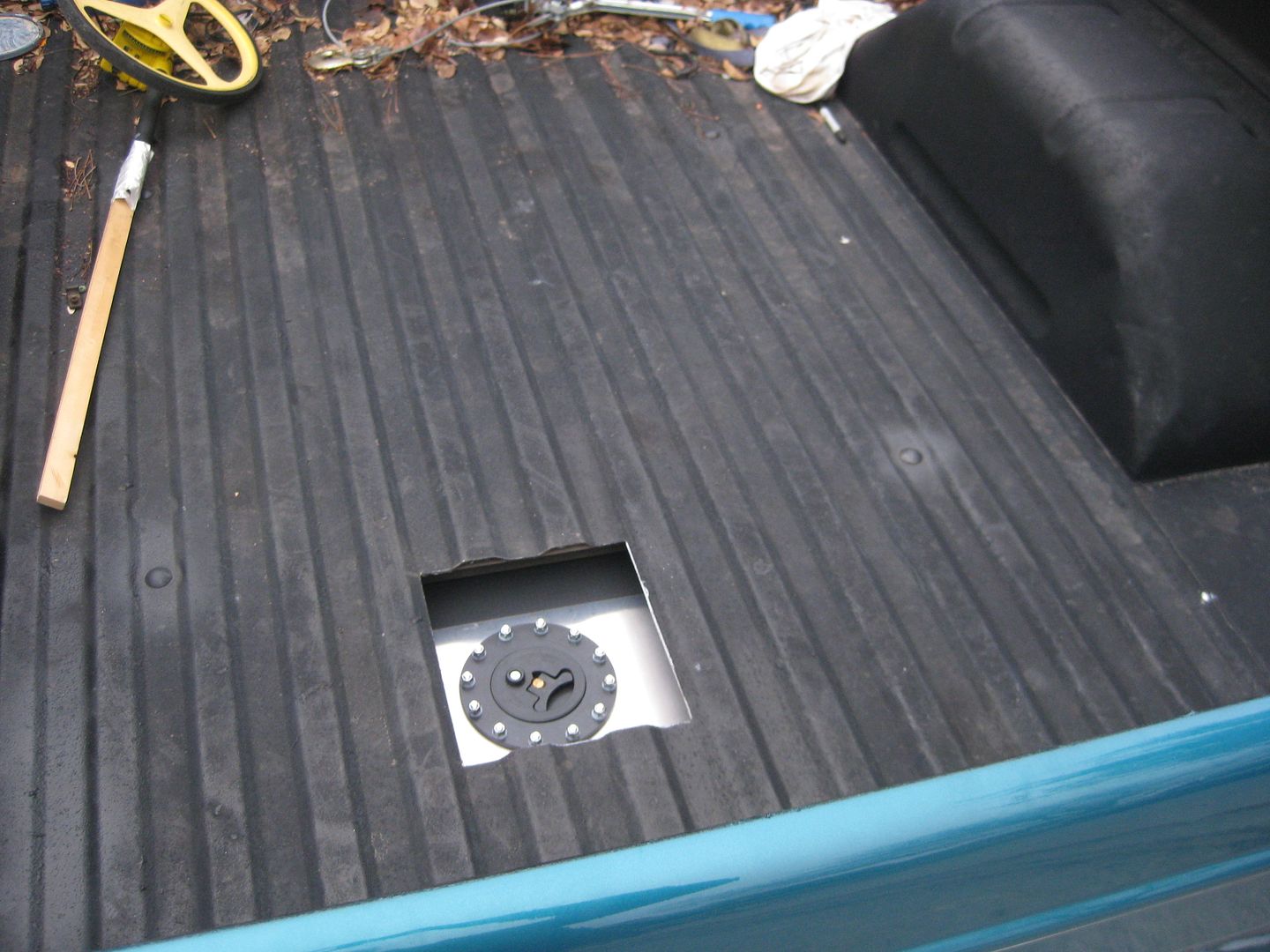

I just finished mine; Jegs 20 gallon fuel cell. I trimmed the next to last cross member, fabbed a fuel cell mount and cut a hole in the bed. The pics make the tank look like it hangs way below the truck but it really does not. Maybe 2 inches below the bumper line. I could have got it another inch or so higher if I would have taken the time to do some more fabrication; time is a factor though. I still have to put hinges on the door with a latch. I have aftermarket gauges so the 0-90 sending unit worked with them. It is nice having room behind the seat!

That cap is going to cause you problems and if that tank had foam in it I hope you removed it

Well, the cap problem showed its ugly face this morning. I filled the tank up for the first time and it leaks like a M-Fer! I will order a different type cap assembly tonight. I think I know why you said take the foam out? If it is because it degrades and clogs the fuel system???, there are many different reports and opinions on if and why it happens. From what I have read; most people have very few problems with the foam and the ones that did usually had an unique situation why it became a problem. I am going to see what happens with it.
