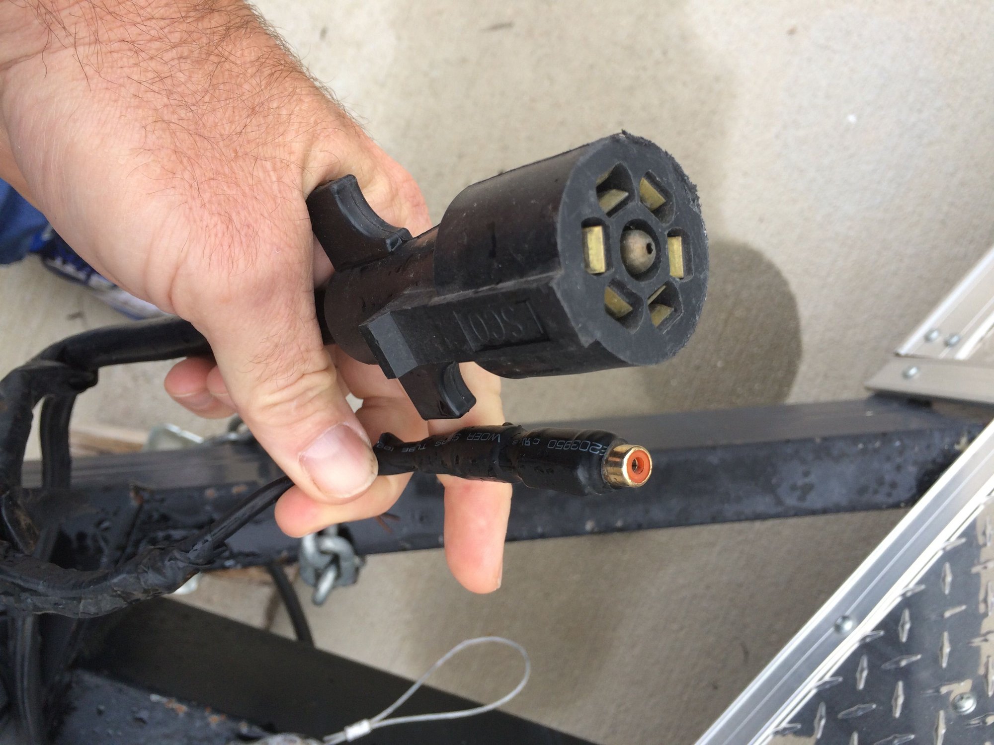

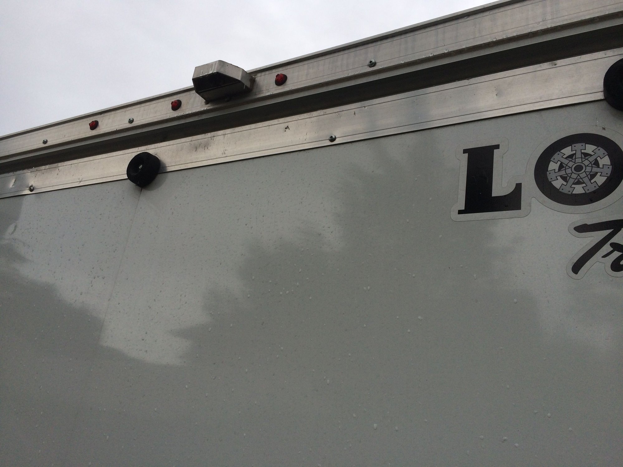

Couldn't you use a waterproof plug from the pos/neg video to a rca for the second camera? Then simply reconnect the two when the second camera is not in use. If you use the backup lamp positive lead from the trailer it should power the camera as it would from the truck.
Old Jul 22, 2015 | 12:28 PM
Fasttrax's Avatar
Fasttrax
Joined: May 2001
Posts: 61
Camera connected via rca video with power to backup light positive.
Rca plug. Trying to adapt now from my f350 to a 2015 f150
