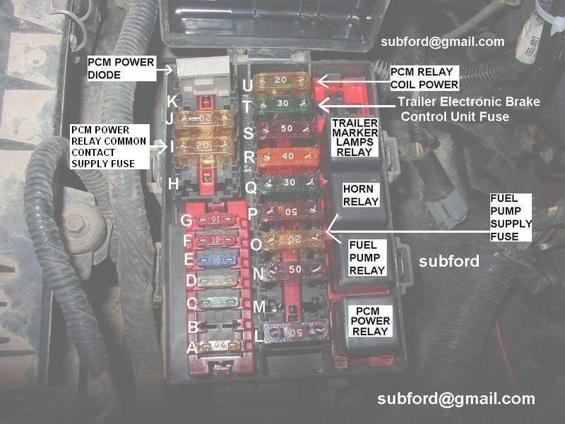

You're describing what happens if the computer doesn't power up. There is a power relay under the hood that supplies the computer. I don't have a diagram to tell you where it is, but that's the place to start. Without power, the trans starts in fourth gear but will downshift to second gear if you move the shift handle to the 2 position.

When your tach doesn't work either,your relay is probably ok.Instead suspect a blown fuse at these locations: U and I as shown here:
Don't worry about this being for a gas engine specifically.The fuse locations feed the relay and tach just the same in our IDI diesel trucks.You'll find one of these is blown.If I wasn't so lazy I would look it up to find which one feeds the tach (I can never remember) but oh well,it's a 50/50 lol,you'll see it quick enough.Replace it and your tach along with trans power will both be restored.
