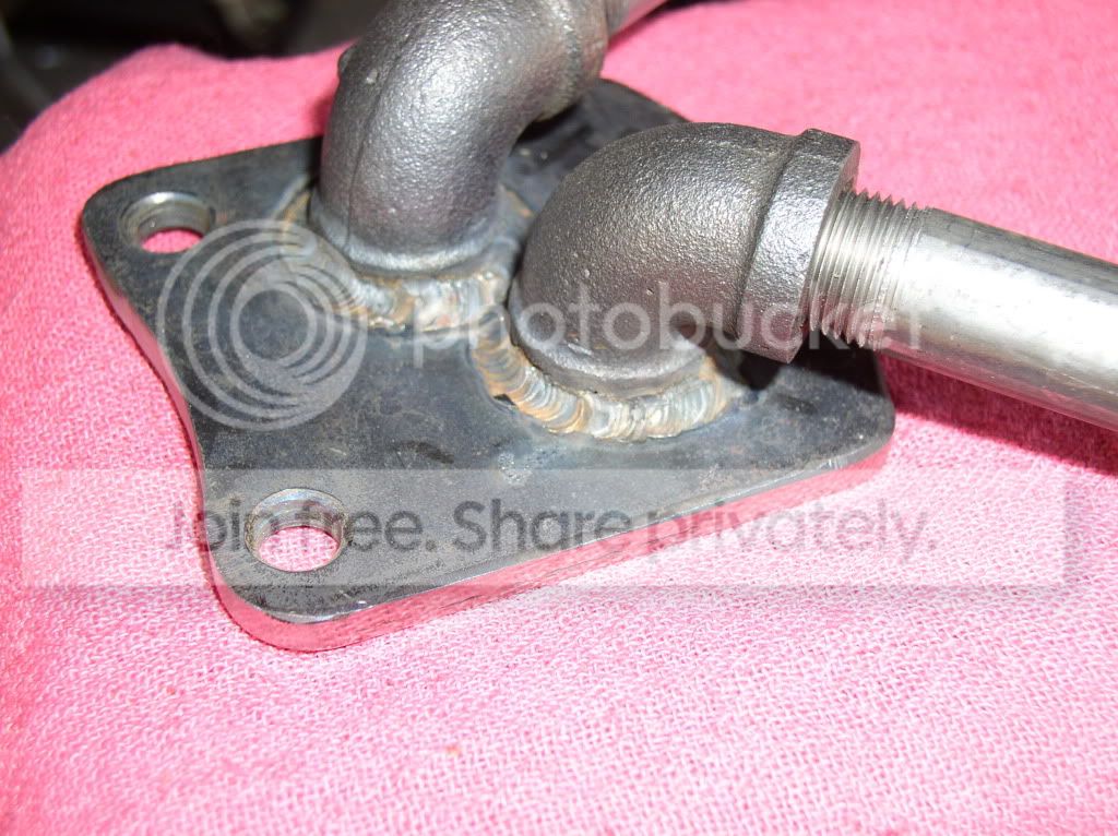

The template gasket is FelPro - MS90157-1
O'Riley had it in stock.. weird.
Do you guys think 1/4 pipe will work sufficiently?
Old Apr 28, 2014 | 11:25 AM
  #45
F-250 restorer's Avatar
F-250 restorer
Joined: Mar 2008
Posts: 7,184
Likes: 381
From: Near Los Angeles
Just use 3/8" galvanized pipe, an eight inch nipple is fine, with 3/8" elbows. That way the heater hose can be put on without a hose bib fitting. Just cut off the threads on that side and bevel the edge with a grinder. Use the gasket as template and mark/drill holes. Drill the fluid holes staggered, one further forward toward the single hole side. I drill those about 3/8". Angle the pipe toward the corners like the photo in the thread. Take the plate and elbows and pipe to a shop and have them put weld the elbows to the plate. Just mark them with a felt pen so they know how to align. Then have them put a bead around where the pipe threads into the elbow. But gasket material and use the gasket again to make a gasket, apply rtv to each side, and away you go. That is exactly what I've been running for 3+ years.
Unlike the photos, have a weld/bead put around the threads on the tubes too. You want the the pipes angling out, and both tubes should be long so they clear the bottom of the intake, away from heat and easy to check and tighten the hose clamps, etc. k
