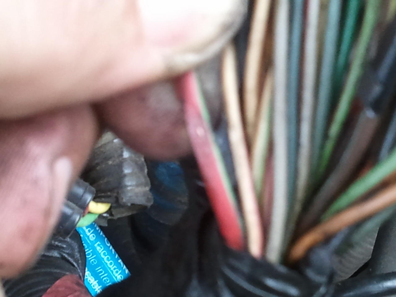

Originally Posted by nookiemonster55
yep see where its rubbing the valve even rubbed some adhesive or some type of labeling off of the vc.... diving in now pictures to come!!! god i hope this is it....
Good luck! I Hope that's all it was!

Success!!! bad eyes and all got my reading glasses and found this little bugger...Name:  2011-09-04 15.16.23.jpg
few others frayed but no wires showing so i electrical taped individually and finished off wrapping whole harness that was exposed....hooked all back up... left the bowl heater unplugged ( i live in Mississippi so no need for it I think), fired right up, gauges, all is good!! and.....wifey happy!!!
Wonder how much they would have charged at the dealership.....figure i saved about 400 bucks easy....
Reps to all.... now to figure out how to give them out LOL
Thanks a bunch guys....

Good job!! I love it when a guy keeps trying and gets'er done in the end!
