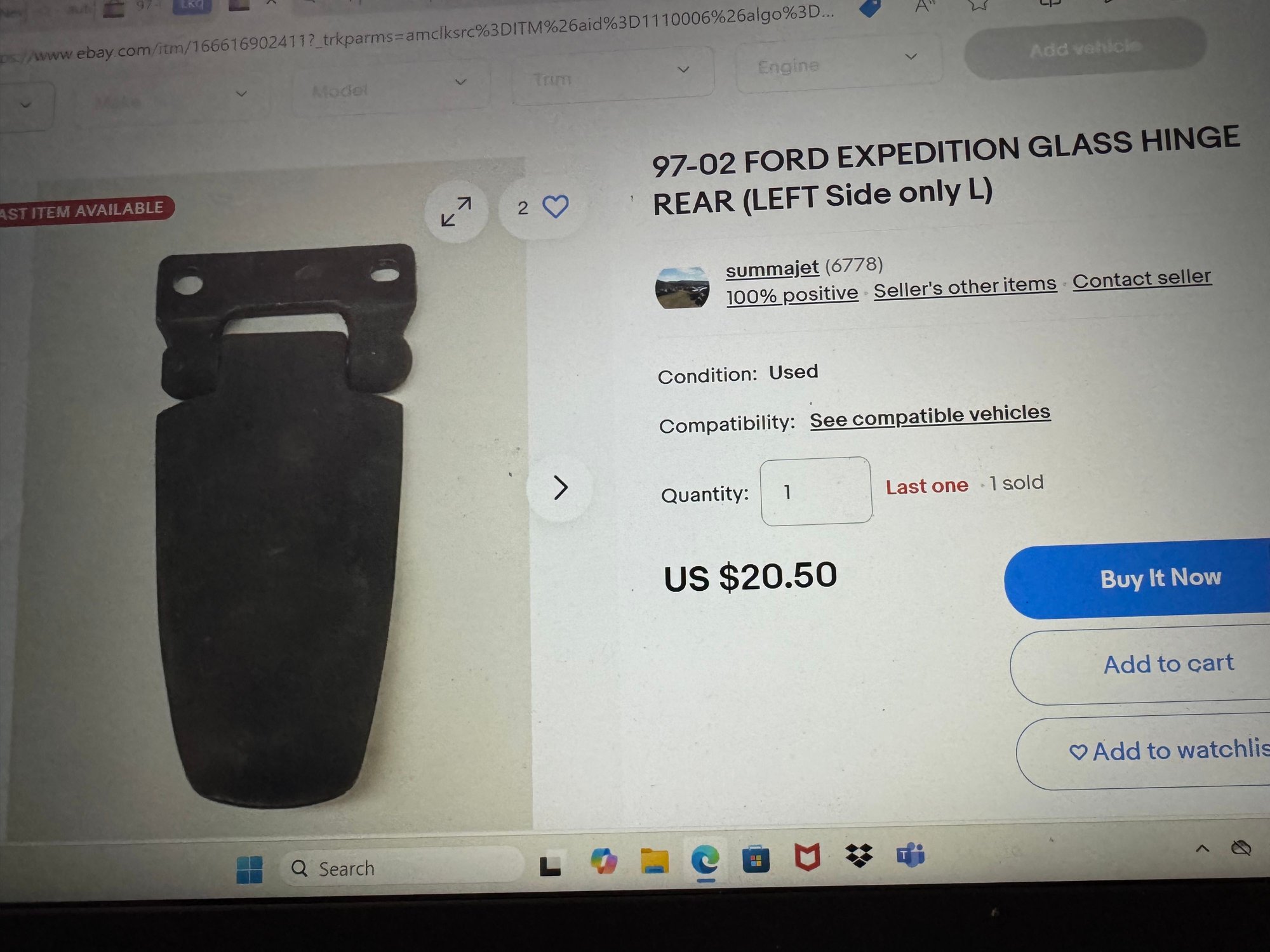

I. Priced one of the hinges has a piece broken off causing the glass to be loose could that cause the lights to come on randomly when the car is off?
This is the type of hinge it has
