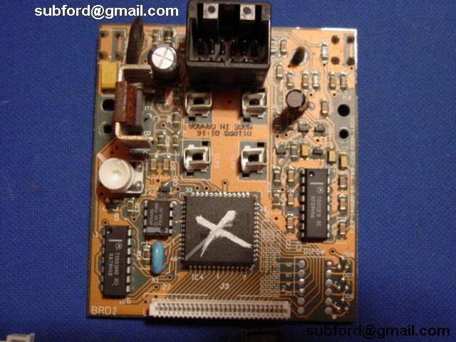

You just take the cluster all apart and remove the PSOM.
The PSOM:
Attachment 280340
