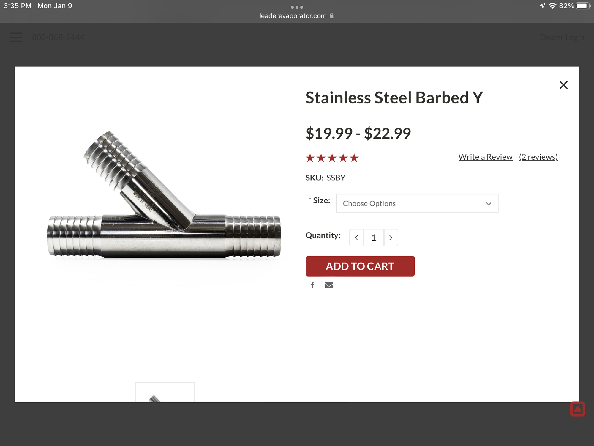

This is a perfect replacement for the Y part of the hose. A little pricy but you will only have to fix it once. I think Cheezit (or maybe it was Mark.. been a while) posted a link to it a looong time ago. I have one on my truck. You can cut your old Y off and put tis right in place of it or do new hoses whil you are there but it’s the correct sizes on all three ends.https://leaderevaporator.com/stainle...ing-y-fitting/

It's 1"x1"x3/4".

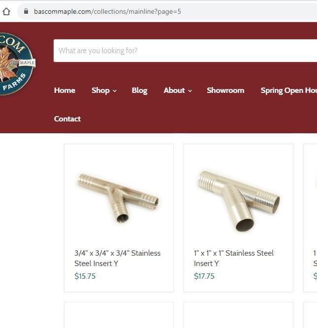

I googled that SS wye fitting and found another "maple farm" type website that lists;
So... WHICH SIZE is correct???
They list other sizes too;
https://bascommaple.com/collections/mainline?page=5
Let me know asap PLEASE!

You need a 1" on the straight, 3/4 on the Wye.

Got it... so I need a 1 x 1 x 3/4 (wye)

https://bascommaple.com/collections/...roducts/mry2ss

Well we may have messed you up. I saw the 1"x1"x3/4" and linked you to it. That is the size of the WYE under the degas bottle.
I have not messed with any other one (not ever worked on an Excursion).
The one under the degas bottle has failed on a number of people, so yes - replace it also.

The heater hose one is probably 3/4" on all nipples. Sorry.

This thread indicates 3/4" all the way around. @Toreador_Diesel can confirm.
