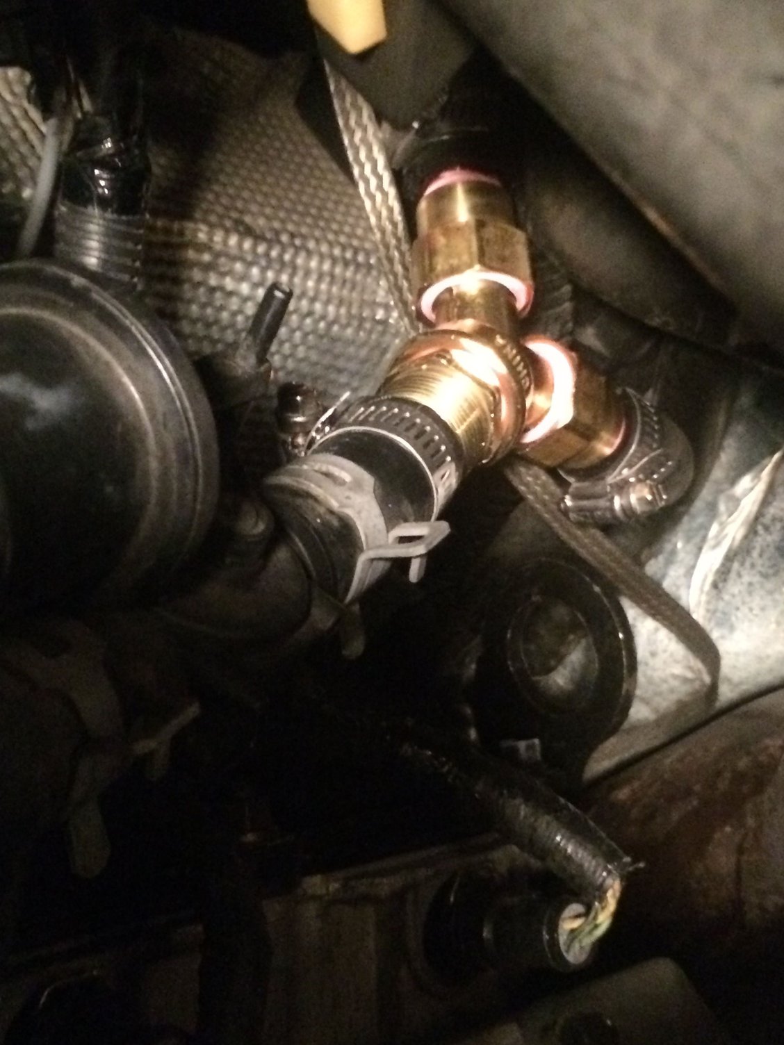

I just did this repair and it's holding very nicely.
I didnt' want to pay Ford $300 for the hose and their crappy connection, so I cut the Y as close to the top of the hose as possible and used some copper piping to permanently fix it.
I had to "sweat the pipe" and solder some fittings in, but it's not as hard as it looks or sounds.

Any concerns about how the copper and solder (lead, silver, etc.) will react with the coolant additives at 200*?

It's been almost a month and not a single drip. I ran it hard, let the cooling system pressurize, let it sit for 30 minutes watching it as it idled in the driveway. Plus the solder I used was rated to melt at 430 degrees. By the time my truck gets that hot, I'll need a new engine anyway, lol!

Sharing is caring, I see you used a y pipe to a hose connection, but what did else did you use.

Yeah, thread from the dead... I'm in this same position right now and am about to go parts hunting. Did you use 7/8" or 3/4" pipe and fittings? I measured out the original as 7/8" but that doesn't seem to be very common.
BTW, the hose assembly is now obsolete and there's not a one left in Ford inventory in the USA.
On edit: Built this myself tonight. Use 3/4" copper pipe and fittings. Thanks for the great idea.

Here's how it's done
Originally Posted by SmackDaddy View Post
Please share details, I need to make one for my truck as well. Thanks
I used 3/4" copper pipe and fittings. You'll have to sweat it, but that's no big deal if you've never done it before.
You need:
6" length of 3/4" copper pipe cut into three 1-7/8" sections (give or take a little)
1 right angle male/female fitting
1 tee fitting
Assemble as shown.
