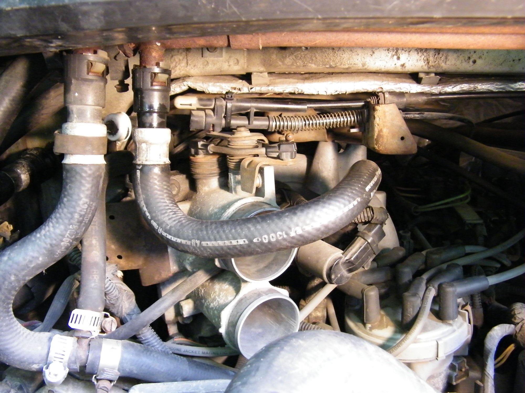

New member here. I have recently purchased a 1989 E150 Club Wagon. It has a coolant leak on a connector at the end of a heater hose. Looking up heater hoses on my online supplier, I see there are many to choose from. I do not know which hose this leaky one is. Is there a diagram the labels each one? By the way, the e150 has rear heat. Thanks for any help! It is the hose in the center of the photo.

Try 5/8" . You may want to find the molded hose that fits your van. If you buy 5/8" hose by the foot sometimes the hose kinks as you try to make the turns.

Yes, I intend to get a molded hose. I just don't know which one this is. Also I need one with the plastic connector as this connector is cracked.

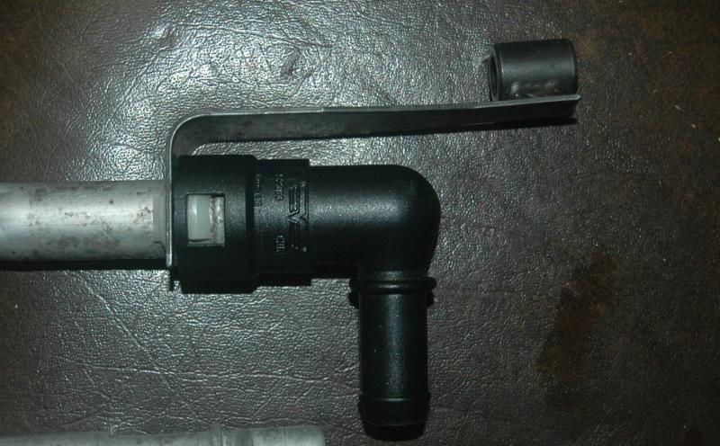

Using the correct tooling these type connectors are removed damage-free daily, no breaking anything on purpose to do so. Here's a few photos...........

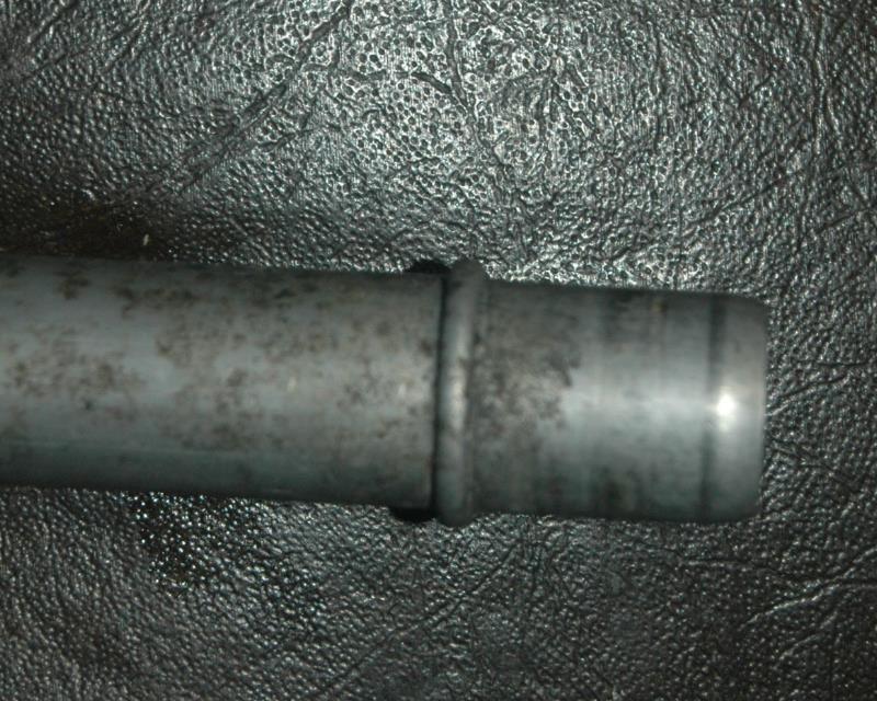

Showing the tube as it exists under the connector:

Showing a typical QD installed on a tube and how the proper tooling is used to remove it:
I would suggest using a small amount of PB Blaster etc around the connector where it meets the tube so its a bit easier to pull it away for removal. Once the tool has been inserted twist the connector back and forth a bit to further loosen it from the tube end. Push inward on the QD with the tool still installed before trying to pull it away from the tube and it should come off. Be careful at this stage to not exert too much force to prevent damaging the heater core or the tubes. It might take a few moves to completely free the connectors but they'll come free with a bit of gentle persistence.
Once the QD's are free use a bit of fine Emery cloth or sandpaper to clean the tube ends of any burrs or debris that might have formed over time.

It should also be noted if you have a heater hose with that formed ridge fitting proper sized hose over it along with a worm-drive or pinch clamp work well too--I've done that for emergency repairs while out on the road.
