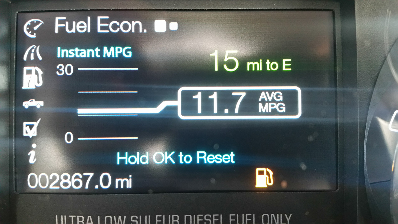

If the Fuel Level Low light comes on I have 37 miles to empty on my 2016 and it is very accurate by doing the math.
Proof of the Fuel Level Low Light Is active @ 2866.4 miles
This image is showing 15 miles to empty and the odometer is reading 2867.0 miles.
If you look at the file name of these images you will see they were taken on April 1, 2017
This image shows Trip A at the time of refuelling, which is reset at every fuel up. I have the short bed with a 26 gallon tank.
You can see the computer has recorded I have used 23.9 gallons of fuel, traveled 246 miles since the last fill up and has an average of 10.3mpg on this tank. This contradicts the previous image that displays 11.7mpg.
This is an image of my log book from April 1, 2017
I recorded the mileage at 2867.0 traveled 246.0 miles since the last fill up and pumped 23.5 gallons into the tank. Doing the math that equated to 10.4mpg. 26gal - 23.5gal = 2.5 gallons remaining in the tank. 10.4 x 2.5 gallons = 26 miles till my fuel tank is empty. The computer was showing 15 miles to empty. At 0 miles to empty the computer would have said I would be out of fuel, when in reality I still had one gallon or so in reserve, which is pretty damn low considering that 1 gallon has to cover the entire bottom of the fuel tank.
Where is that 4 gallons of reserve you are talking about?

Originally Posted by dirthawg
I call BS on that statement and challenge you to prove it.
Let me rephrase...once the fuel guage is on empty there is usually still about 4 gallons in the tank. I was not referencing the low fuel light at all, but the DTE calculation. But your vehicle will not be "out of fuel" when the DTE reads zero, or at least it wasn't on any of the 4 trucks I've owned with this feature. Ford has always held fuel in reserve in an effort to prevent people from running out, though it still doesn't work. How much fuel varies from vehicle to vehicle, and from 1 tank size to another. I don't recommend driving until the display shows zero, nor do I recommend using the DTE or AVG MPG as spot on accurate, because they aren't. I recommend filling up once you get below 1/4 tank when possible regardless of the DTE. But, if you simply cannot, you'll probably still be able to drive 10-20 miles before your engine dies.
Okay I'll let ya slide by on that.
I don't pay much attention to the fuel gauge but I think it reads empty at the time the fuel light illuminates which is at 37 miles to empty and for me that's about 4 gallons left. I would agree, the larger the tank the more fuel that's left in the tank at empty.
