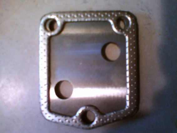

Offenhauser heating plate
Moderator: Is it possible to be able to have separate threads for diff. topics in the Tips section. It would make it much easier to find items of interest. Lumping it all together seems pretty sloppy.
Forum members: If you're installing an Offy DP or 'C' type manifold, you need one of these heating plates that bolt to the bottom of the manifold and allow you run engine coolant through it to keep the air/fuel mix nice and hot, so your performance doesn't fall on its face. The old Clifford manifolds don't allow for this. The newer Cliffy manifolds have their own system for coolant exchange. Another system is to install a heating plate between manifold and carb, from a 60's era galaxie, but this system, in the photo below, works much better.

A picture of the heat plate installed:

Where would you find this heating plate and what is the path the hoses and coolant would take? I.e. hose diagram?

Also..is it just th c series that needs coolant ram through or do I need if for the do also?

You'll need it for any intake that doesn't have the exhaust heat directly underneath.
The hose connection is almost too simple to need a diagram. Cut one of the hoses to the heater core in half and put the hose ends onto the pipes on the heat plate.
As for procuring the heat plate, it's something you'll most likely have to make yourself or have a shop fab one up. The gasket that comes with the Felpro intake/exhaust manifold gasket is a perfect template.

Is it NECESSARY though? I don't plan on camming the 6 yet..just put in a better intake with a big 2bbl and a header as of now.

Necessary, no. Desirable, yes.
It has to do with the basics of how air/fuel mixtures work. The cold intake floor will mess with any air/fuel mixture, no matter the performance parts. It can cause soggy performance/bogs under certain conditions. Heating the intake floor cures this.
The stock design accomplished this by using exhaust heat.
