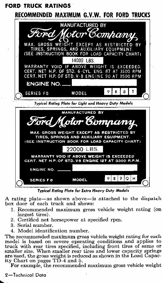

The 51 Serial numbers used the newed format.
But until June of 1951, 51 trucks had the older (48-mid51) style Glove Box Door Rating Plate. These trucks also had the Firewall Patent Data Plate Older plate looked like this (note the pic is scanned out of the 51 Salesmans Handbook):
Name:  Rating Plate 48 to Early 51.jpg
From June 1951, the 51s (and on) used the newer Glove Box Rating Plate - like this (from the 52 Salesmans Handbook:
Name:  Rating Plate Late 51 and 52 B.jpg
