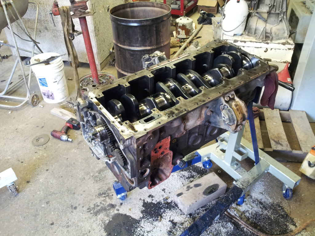

Ok. Got a long overdue update. Cylinder head took a trip it joker Fab in Wisconsin. For Porting, valve work and firerings.
Breaking down the block now to take in for cryo.

I believe So. They crack me up with there long O's. Very nice knowledgeable guys.
IM gonna remove the crank tonight so it will be totally torn down.
Anyone know anythings about crankshafts?? I got a little scratch on mine and IM concerned.

What do you call little? Can you feel it with the edge of your fingernail ?
You could try to polish It out with some 800 grit emery cloth and the follow that up with 1000 grit.

Looking good buddy! Are you missing two piston in that picture of them all lined up tho.
