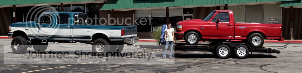

you still need to add an f350 rear spring block or add some leafs,and a front end alignment now.
ideally,that is if you still plan on using the truck to haul stuff,the rear should setup an inch or two higher than the front like stock again.then as you add weight,rather than sinking at first,it levels out.
i dunno how you use your rig though,if its all play or whatever,but just in case ya didn't know.
here's one setup with priority being appearance when empty,and working.light front ends when towing/hauling is dangerous and not much fun to drive either,i know lol.
you could pile the mains right up on her if your set on sitting level when empty.but she's gunna ride hard.
