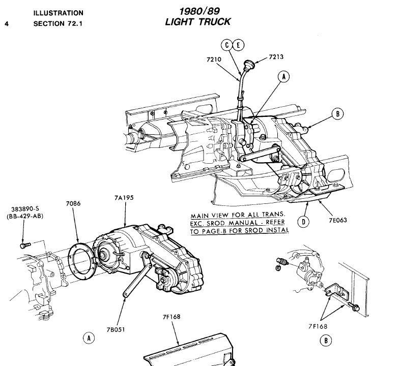

Interesting. If I'm reading that listing right, there were four possible transfer case shifters that could be had with a C6 from 1980-1986.
However, there isn't a clear indication of what is included in the "Lever Assembly". Does that mean just the lever, or does that mean from the lever all the way to the transfer case bracket? If it means all the way to the transfer case bracket, the difference between E0TZ-7210-M and E1TZ-7210-B may actually not be in the lever itself, but the linkage after the lever, or the bracket on the transfer case.
All I know is that my lever isn't like all the ones I've seen in the 1980-1981 trucks, and it's more than likely E2TZ-7210-B.

So heres a pic of the assembly. It looks to be the shift lever is the 7210 part number. The 7B051 rod could vary. Not in your case tho.
So, in conclusion, you have the correct rod already, but need the lever E0TZ-7210-M. Green Sales has 2.
EDIT! There are seperate numbers, as seen below.

Thanks for the info!
I guess I'll keep my eyes open for E0TZ-7210-M.
