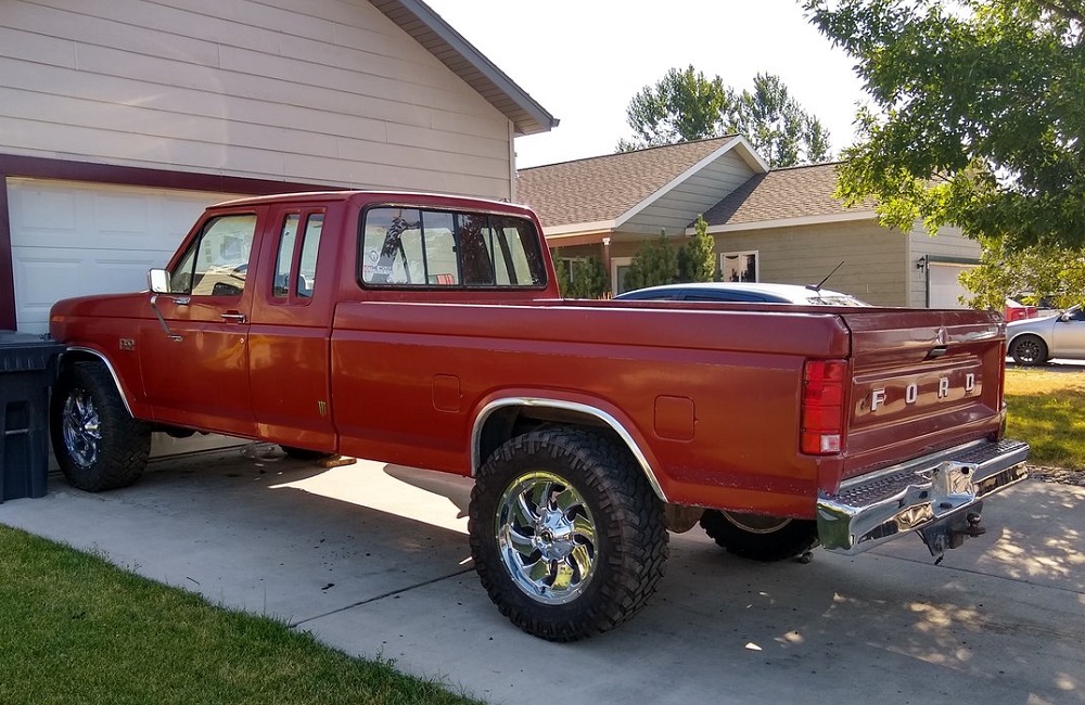

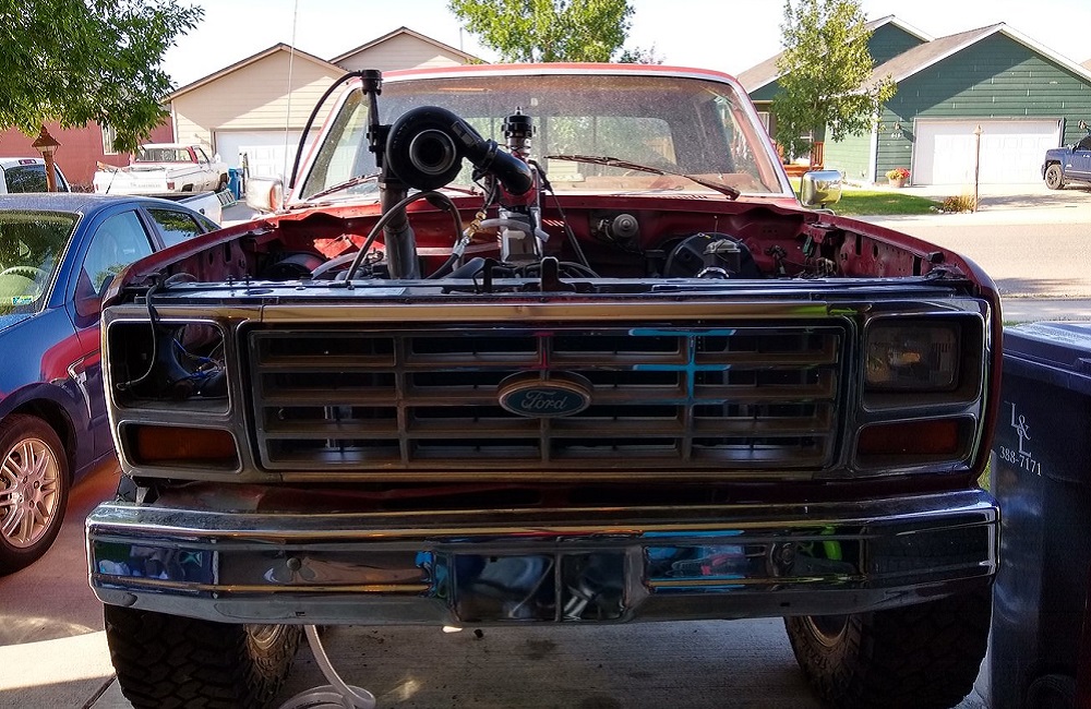

Which brings us to this project by Ford Trucks forum member “Whistling Pete.” He started this thread back in August of last year, and in the best traditions of bench racing, he’s been looking for guesses on how many ponies this turbo F-150 is going to make. Now, there’s nothing terribly unusual about that request, but his photos caught our attention, because the setup looks unconventional, to put it mildly. So far, there haven’t been any real bites, save a wry response from lonewolf, who ventured that zero — as in zilch, nada — is the winning number. Unfortunately for Whistling Pete, he hit the nail on the head — as the 302 Windsor wasn’t running at that point.

At this point, the engine will fire with the help of some starting fluid, then dies, and getting the MegaSquirt system dialed in is proving problematic.
Despite the fact that he’s using the kit for this specific engine, the TFI ignition control module doesn’t seem want to talk to the fuel pump, and when he’s unplugged it, the pump has kicked on. That’s just plain weird. To us, that makes it sound like there’s something spooky happening wiring-wise.
