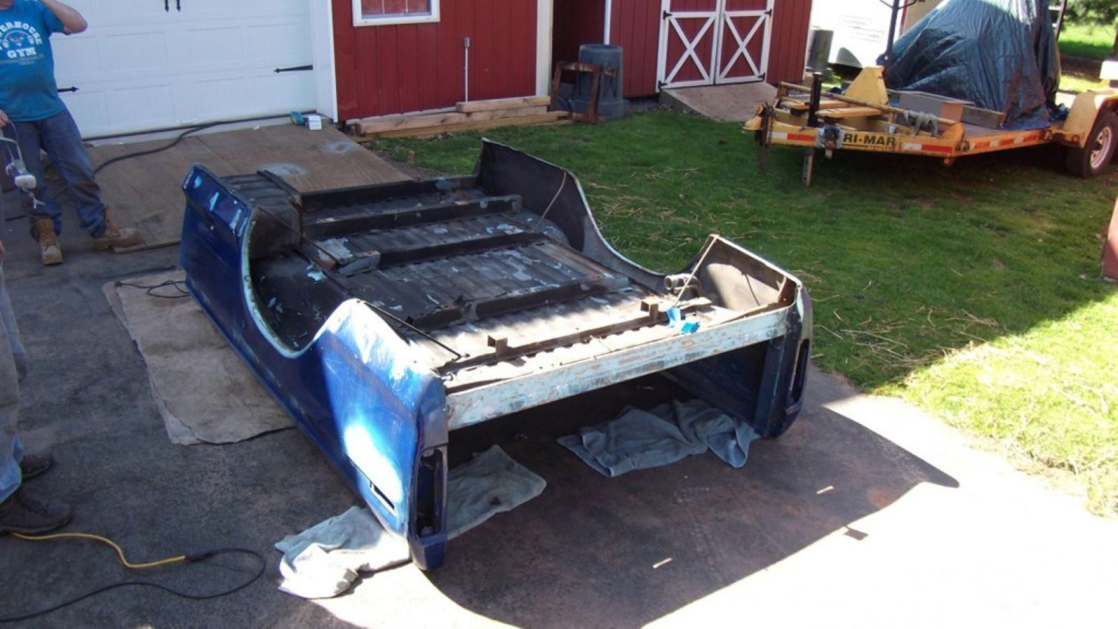

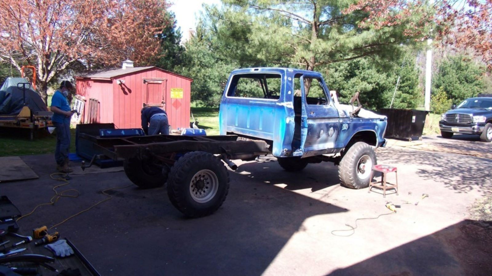

The owner of the truck, Kenny, stripped it down to its bare frame in his quest to make it absolutely perfect. From there, he sealed the frame with Zero Rust and began the process of preparing it to accept a newer 7.3-liter Power Stroke diesel. That involved a little bit of cutting and other tweaks, but the end result would be well worth it.

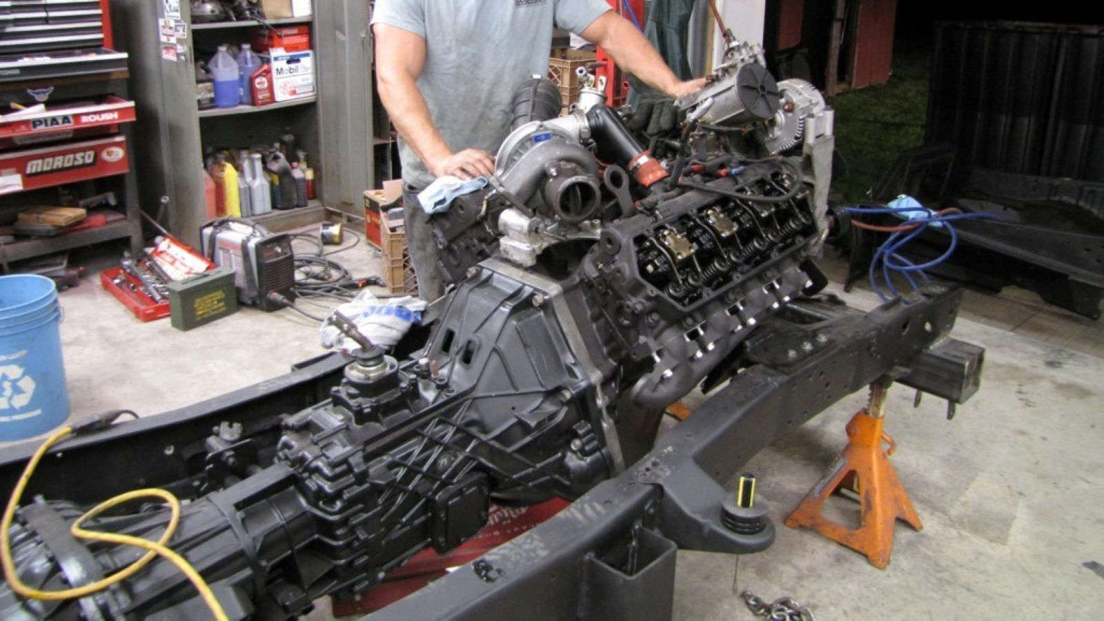

The diesel powerplant was then torn down and treated to a host of upgrades, which include a BD turbo, Banks intercooler, bigger injectors, a TS six-position chip, custom ram air intake, and high-volume oil pump, while the transmission received a new clutch, pressure plate, and throwout bearing.

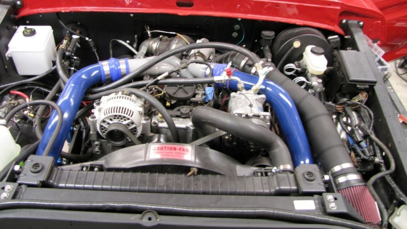

Once the drivetrain was rebuilt, Kenny placed the engine lower in the frame to improve the soon to be lifted truck's center of gravity and driveshaft angles, then fabricated a custom removable transmission tunnel to make it easy to access in the event maintenance is required at some point.
