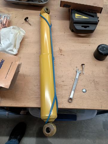

We have been busy, like everyone. The 66 got new Monroe rear shocks today. The old ones were shot.
That was a slam dunk small project while I wait for the welder repair or replacement. Still many things to do , just seems to be busy on other projects. I bought some Clecos and pliers for holding sheet metal. Never had any. Will try them at some point. Maybe on the floor panel? I did slip on a steering wheel and put in an milk crate and moved the 66 out of the lift bay. She starts really good with the EFI! I think this may be fun to drive when back together. First show in the area is next Tuesday About 10 miles from home.

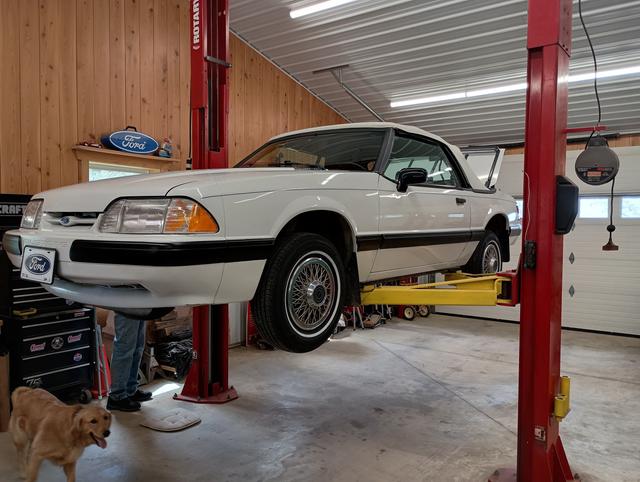

John brought over his wife's 90 mustang and we changed the rear shocks on that today also.

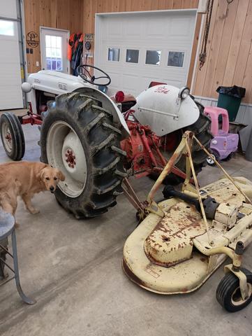

We have been mowing the lawn in between rain drops too. Ford Jubilee and JD 272 mower

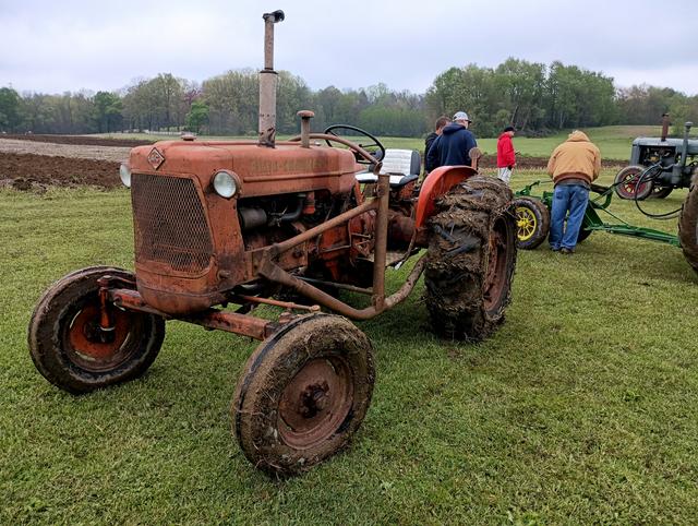

Had a good day plowing ground on Saturday, We used our D14 with two bottom plows.
Ten or more antique tractors made short work of the 30 acre field.

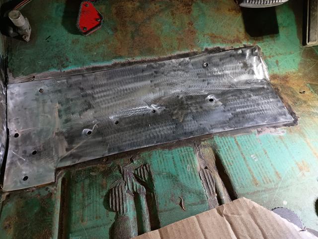

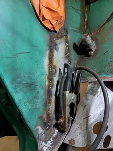

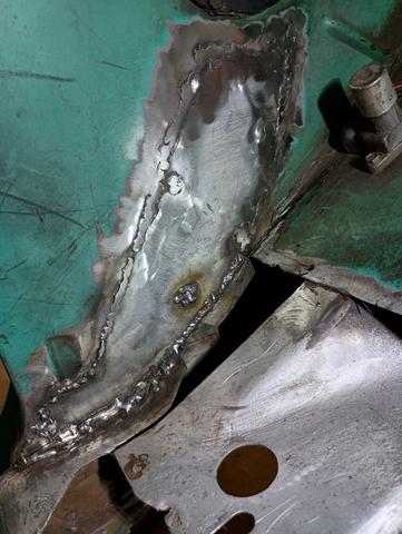

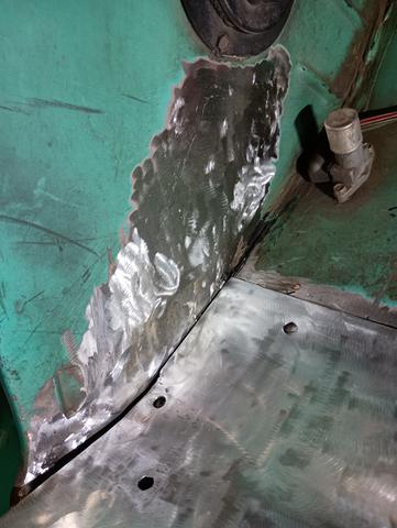

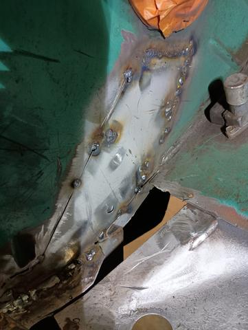

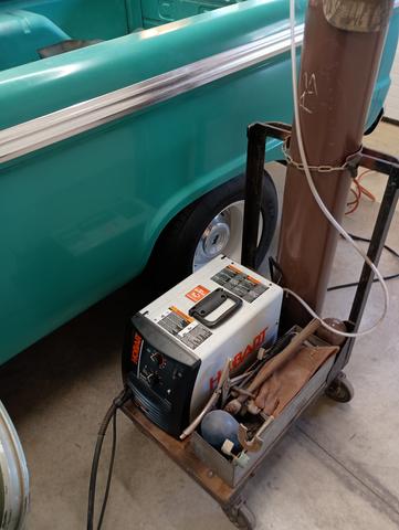

Trying to make rust repairs to the 66 F100 floor areas.

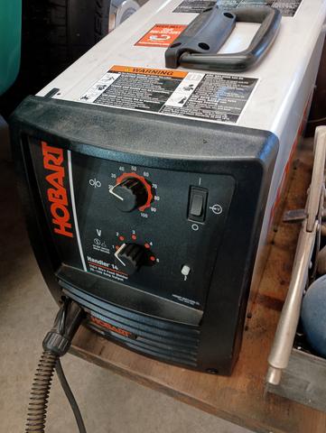

The borrowed welder:
The spot on the side of the foot board
Getting cleaned up a little
The floor panel is next.

IMHO...your welds look cold. I suggest taking a few of your scrap cut outs and butt weld some together so you can see the back side to know if there is enough heat to make full penetration for the weld. I know...I know, too hot and you burn thru, but too cold by the time you clean it up with the grinder there is nothing left of the weld. If you can still see the seam on the back, you're too cold, and also its a good place for moisture to hang in and start the rust all over again. Try an experiment!

IMHO...your welds look cold. I suggest taking a few of your scrap cut outs and butt weld some together so you can see the back side to know if there is enough heat to make full penetration for the weld. I know...I know, too hot and you burn thru, but too cold by the time you clean it up with the grinder there is nothing left of the weld. If you can still see the seam on the back, you're too cold, and also it's a good place for moisture to hang in and start the rust all over again. Try an experiment!
That is the first time I have heard or read the "cold" reference, and it seems fitting. I will try to remember it the next time I need to weld something and also do some practice runs (at this point all of my welding is practice runs) before I try to fix what needs to be welded.
