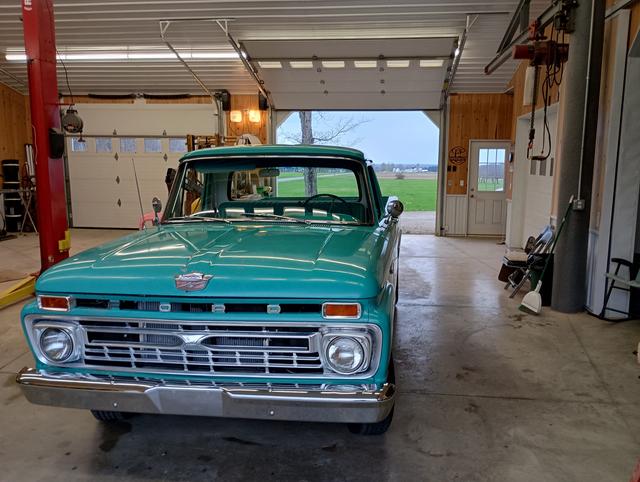

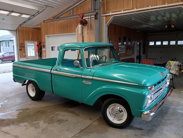

Guys,

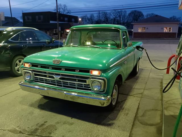

I got Cheryl in the truck last night. Went to town and got some gas and took the long way home. She was scared to death at every turn and take off, even easy starts. She was better during the day today and knowing we were going to get ice cream!
Turn signal light was not functioning on the dash at several times. So it will be good if we can get that looked and hopefully improved/repaired soon.
I did rebuild the drivers side window handle and crank. Added a clip inside the loose black ****. and tightened the handle on the shaft. Better for a shop truck.
Looks like a green truck under the lights:
PA state law says if its this nice out you have to go get ice cream. Had several guys drooling over the 66 shop truck. The banana split was good too!

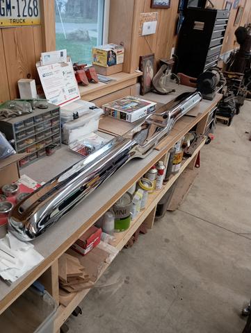

New rear bumper looks great. Shout out to Summit Racing!
The baby's first bath pictures.
We probably put 50 miles on it running main roads but not the interstate yet. It drove very good! for a 66. Shifted into overdrive at about 50. No idea yet how to adjust the idle down just a tad? Might need new shocks on the rear? Hard to tell with the short wheel base, Our roads are not good. We were doing 60-70 mph with no effort and drove steady straight down the road.
Happy with initial testing. The bling on the back suits me just fine.
We stopped at John and Cathy's house. John has been collecting Ford parts for years. His garages are full of Fords. He gave me a new old stock taillight bezel ( I think one fits either side?) and a horn ring internal component too!
Great Grandson Rhett got in and fired the 351 up. He had a big smile! He will be 11 in a couple weeks. He just got the perm, The girls should love that!
Happy Easter Ford folks and families.
