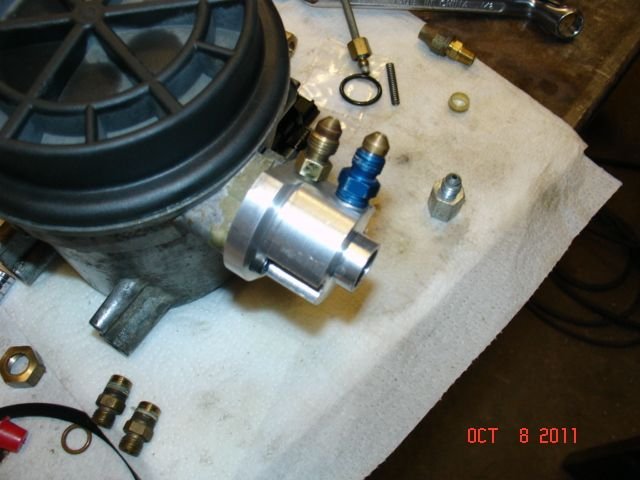

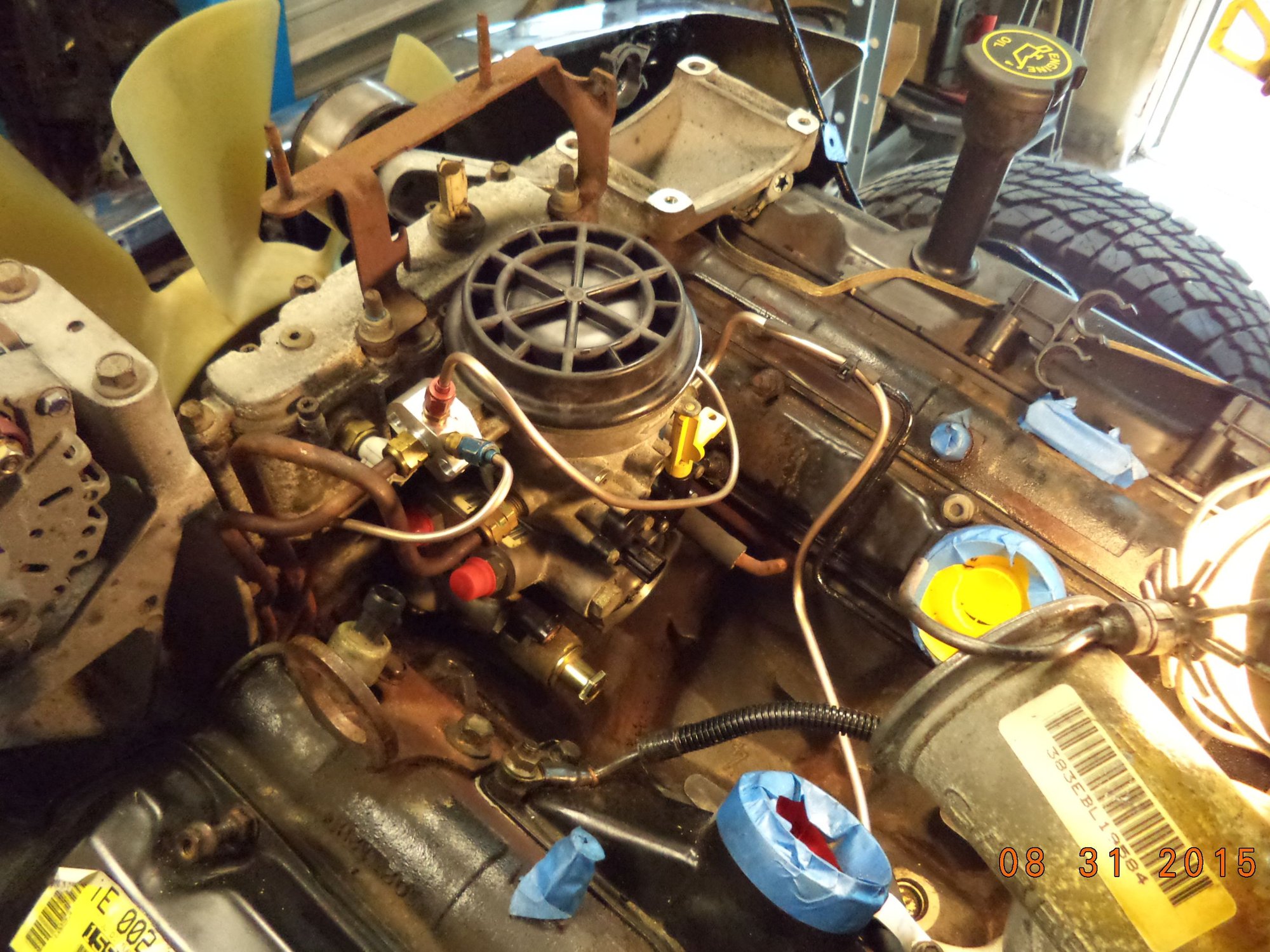

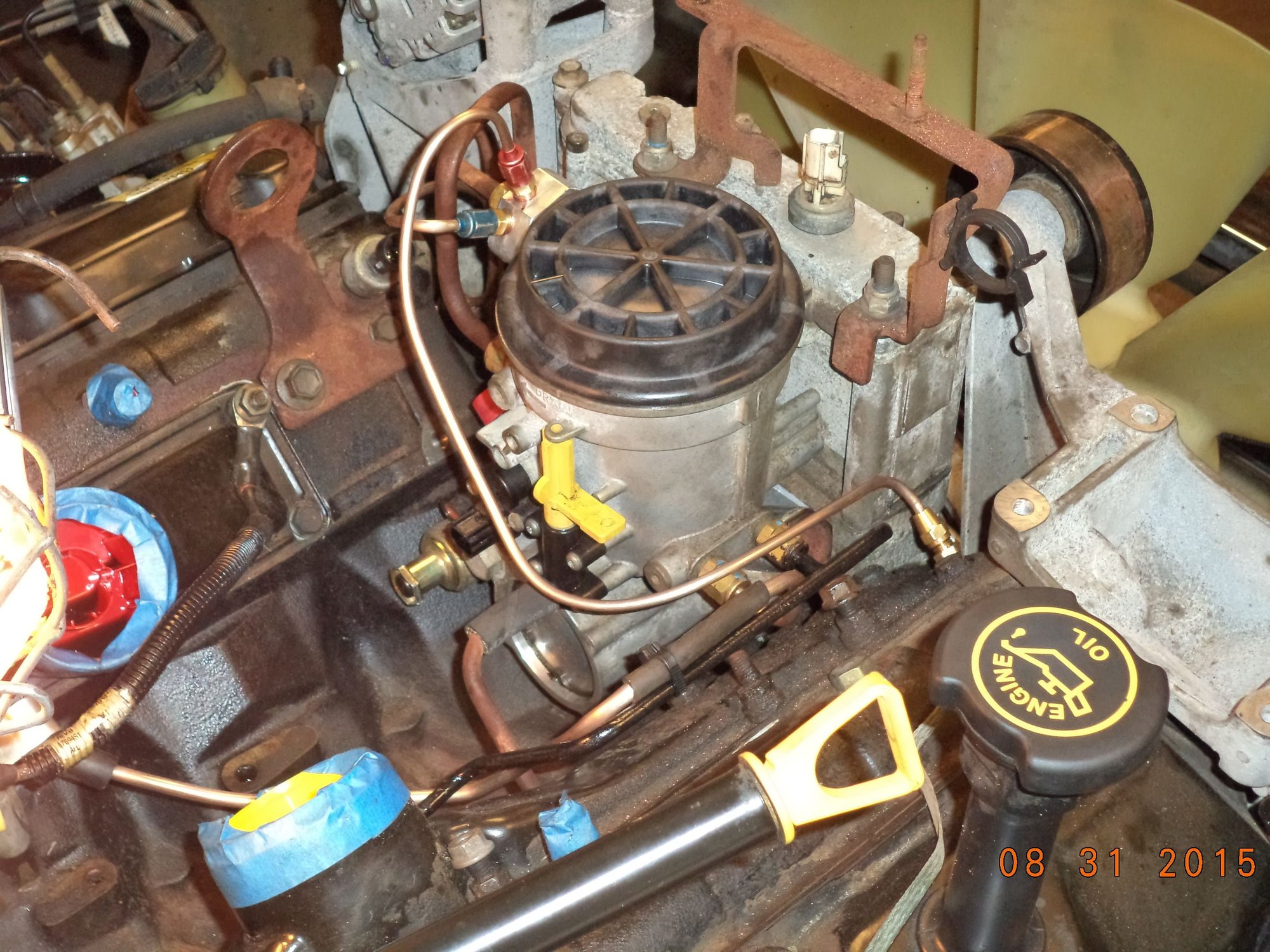

I forgot I made a second one for our work truck when we got it.
The drivers side "feed line" gets routed to the rear of the head so any air that gets in the galley in the head flows to the front (high end) and out the return line and back to the fuel tank.

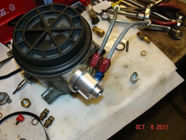

Snow, what did you use there as your regulator? Looks easy enough to build that I don’t want to pay hundreds of dollars for a “kit”, it’s fun building an effective piece yourself!

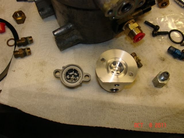

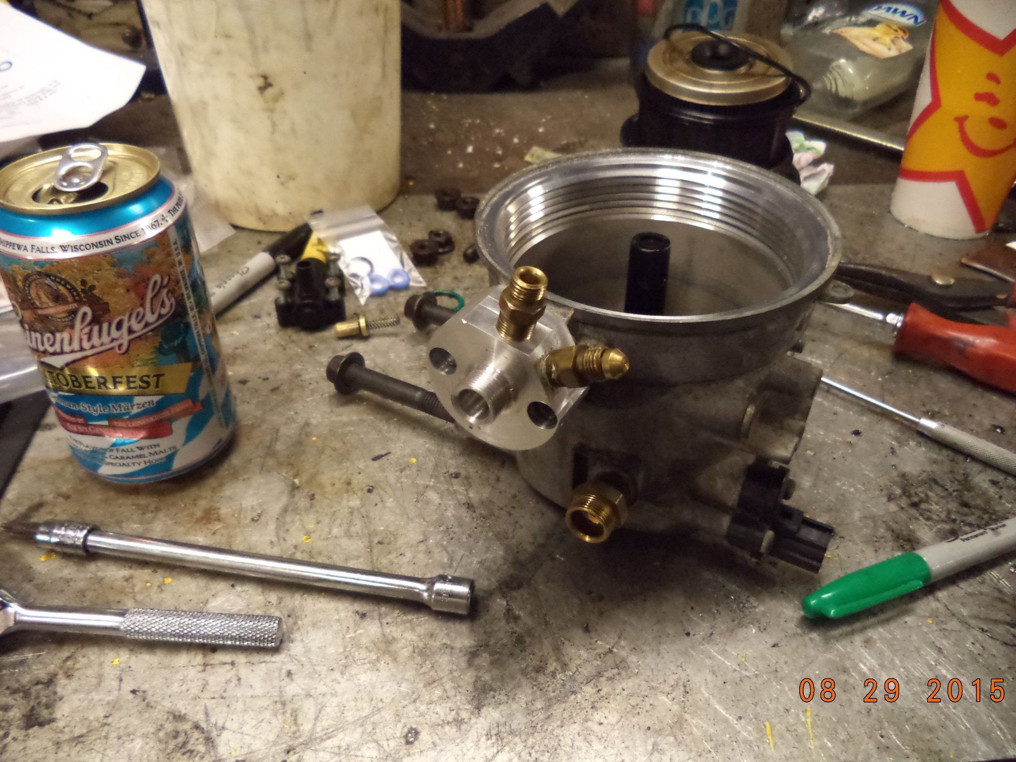

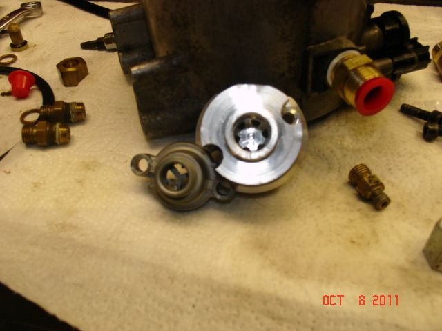

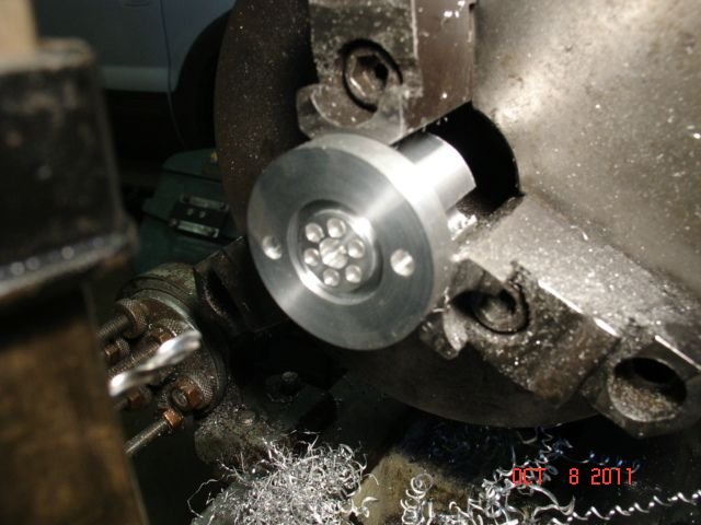

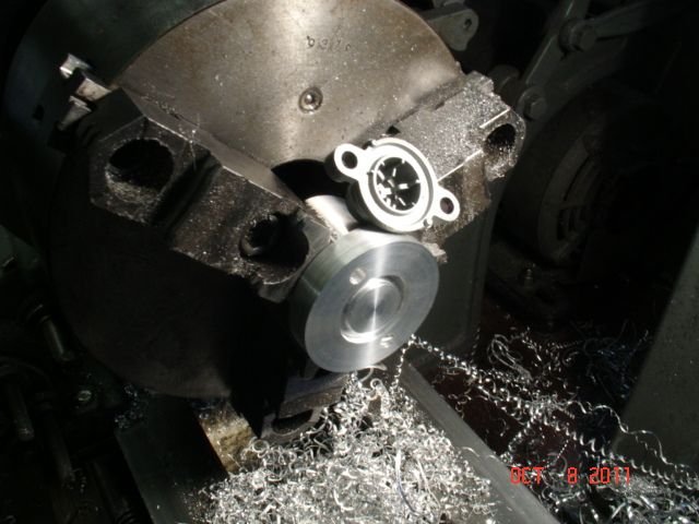

The regulator is just a block of aluminum I drilled out and machined on the lathe. Not much more than the stock regulator just with some room to stick the fittings in. I then just use nitrous jets to restrict the return lines. I made my own nitrous jets too but they could be easily bought.

I made up the regulator block to take all the fittings and whatnot. But in all reality a guy could just use T's and plumb the returns into the main return line after the regulator.

No idea why they didn't implement a return from the heads instead of just the fuel bowl.
I started with some jets I had on hand. I never ever once checked fuel pressure. Even with what I felt to be a "bit big" jet in the works the truck acted normal. I forget the sizes (drill size) I settled on but it is quite small. I felt there was no real reason to move a lot of fuel threw the heads and to the return. Just a small small jet to let any air bubbles that enter the heads a place to escape. I'd be willing to bet I copied (drilled) my jets to the smallest nitrous jet available.
