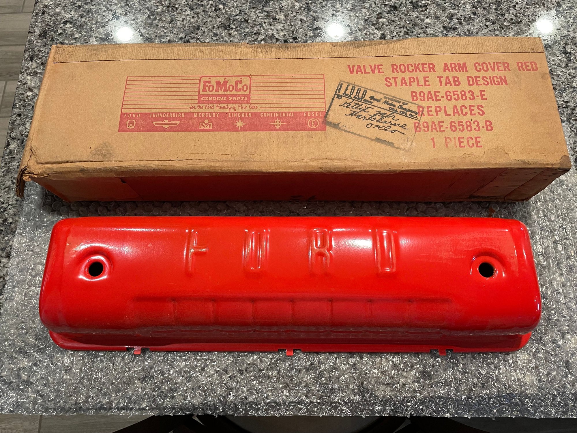

Yes! I dearly apologize for the very delayed reply. The project is moving slowly, but faster than ever (in between family events, post-retirement work, and other car projects). Several small (and very time-consuming) miscellaneous items completed since the previous post.

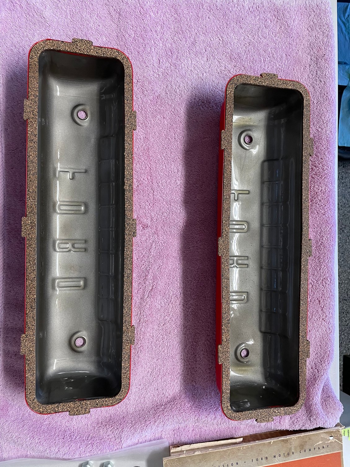

-Powder coated good original and NOS valve cover with a powder exactly matching the paint of the NOS item

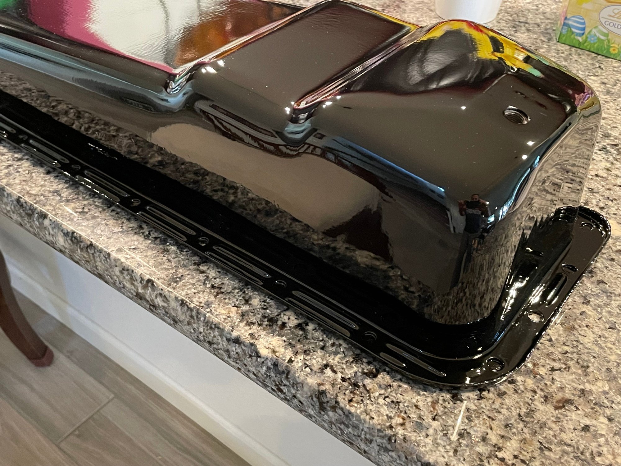

-Powder coated original oil pan and external oil pump pickup tube (for durability against road debris)

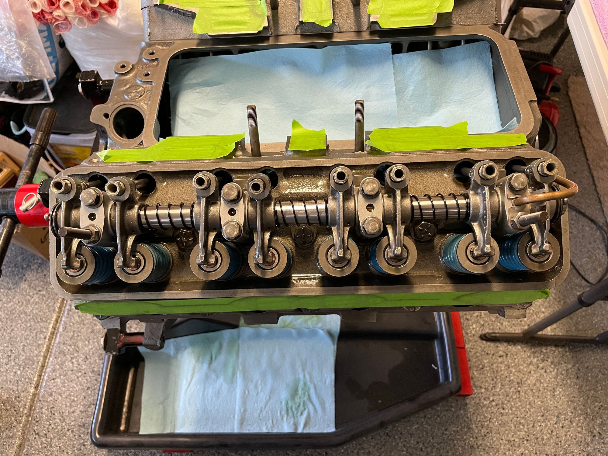

-Set cold valve lash and installed valve covers with new gaskets, grommets, and re-plated original lock nuts

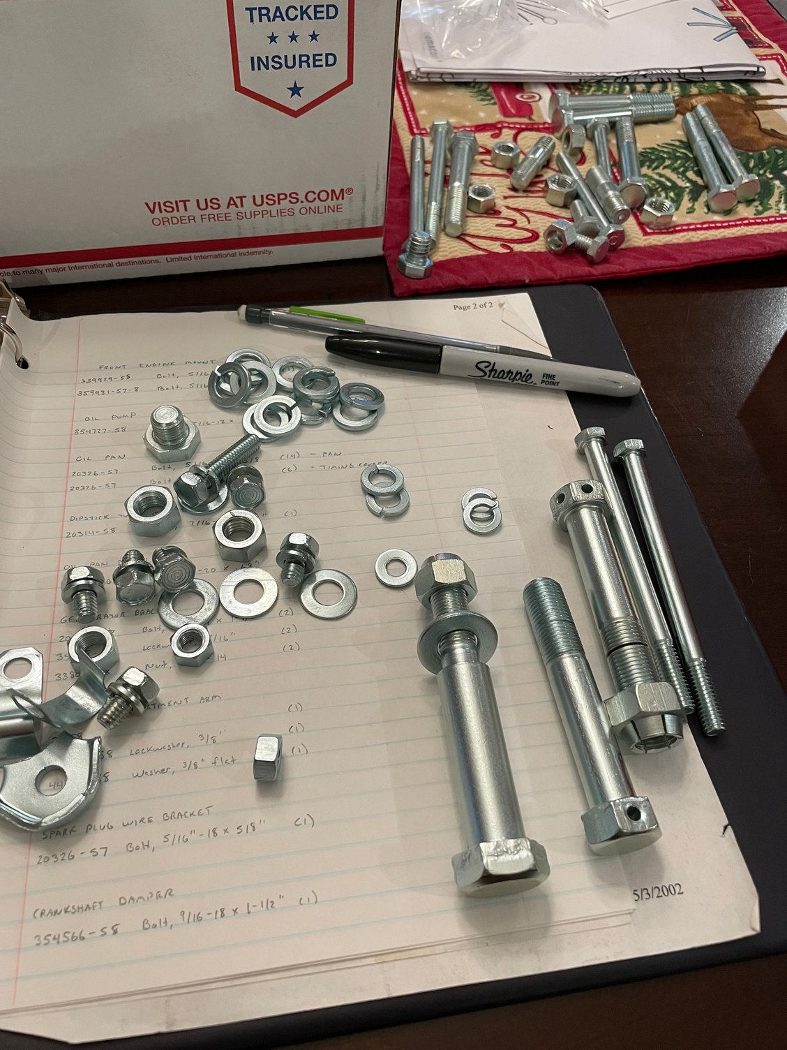

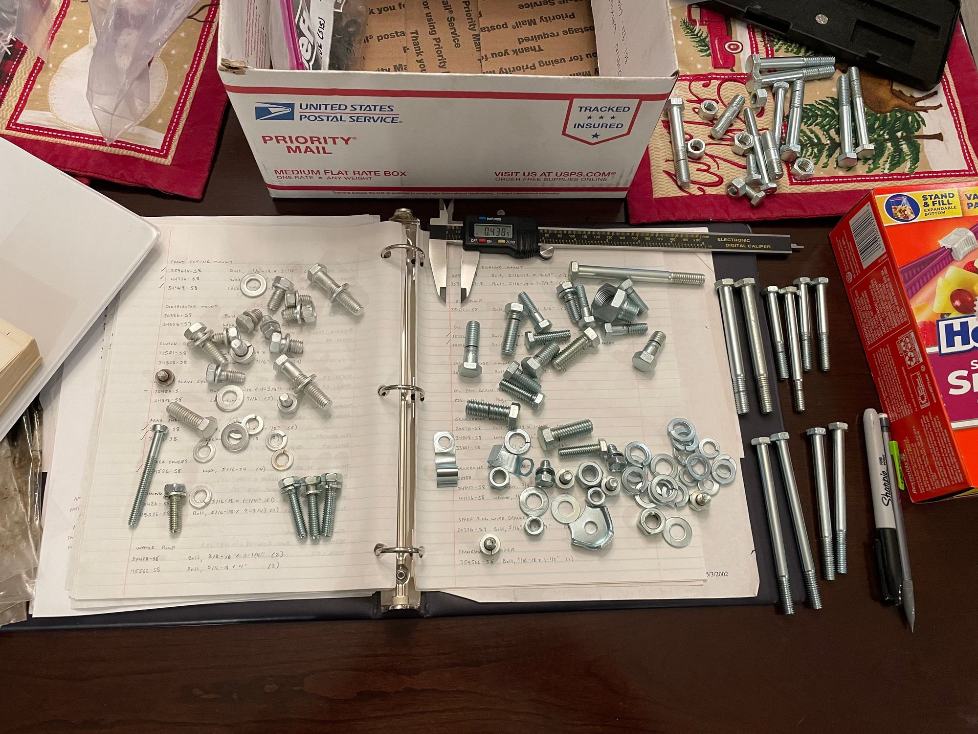

-Tumbled/stripped and re-plated all original engine exterior hardware in zinc, cadmium, and block phosphate per original

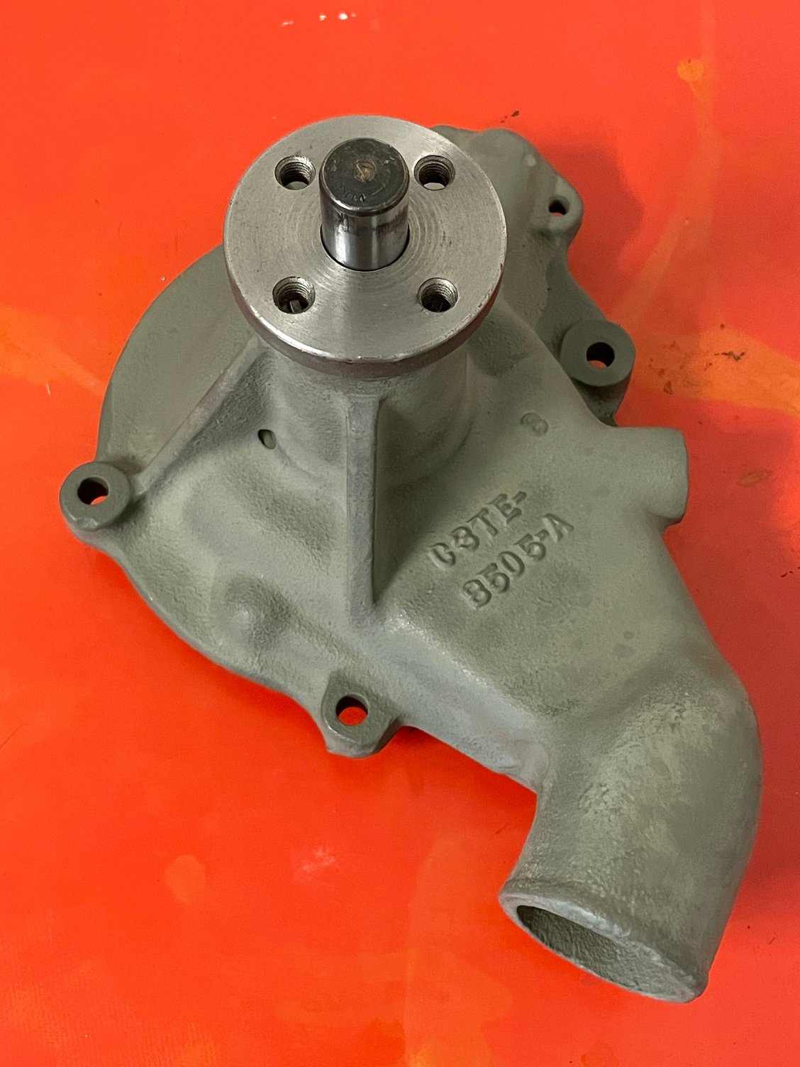

-Rebuilt/restored water pump with new bearings and seal

NOS valve cover before powder coat:
Valve covers after powder coat:
