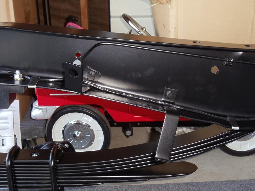

There has been some long overdue progress on the restoration.
Complete:
-Built and installed rear springs (minus rubber pads and straps)
-Installed differential
-Installed mid and rear parking brake brackets
We are in the process of moving to Alaska, so there will be yet another pause in the restoration until we are all moved in and settled. Enjoy the pictures and I'll keep everyone posted on the progress once work resumes. Anyone recommend a good machine shop in the Anchorage area? I'd like to start with the engine machine work soon after our relocation.

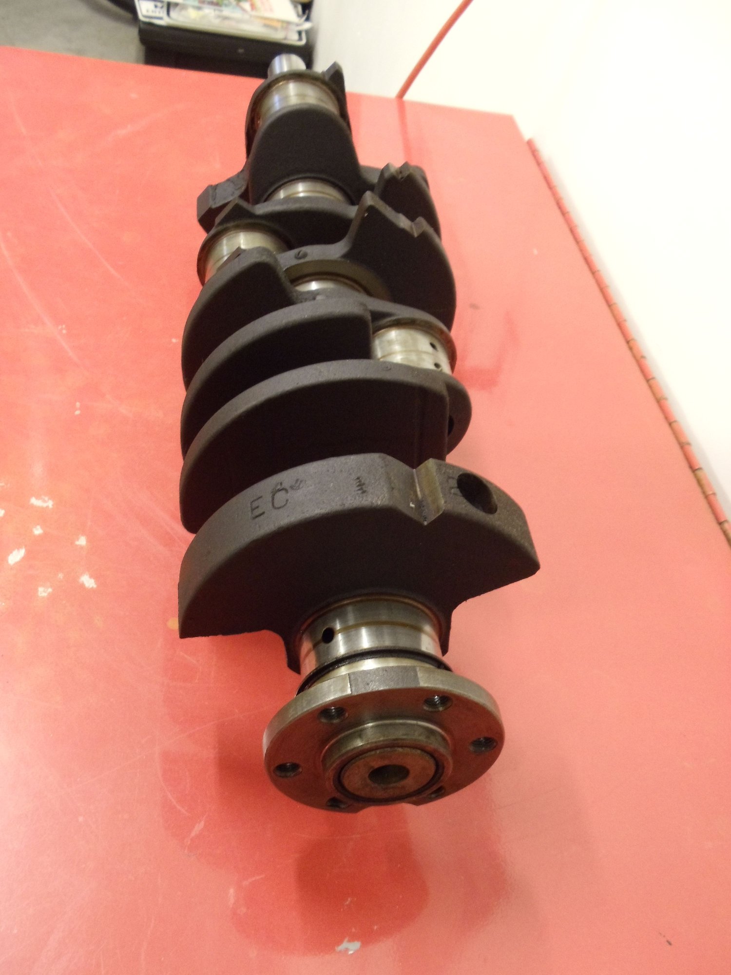

I apologize to the late reply. Thank you for all the positive comments. Over the past few months I have acquired several NOS parts to complete the chassis and begin the engine rebuild. Also completed is the refurbishment of the crankshaft (hot tanked, shot peened, cut .010 under, and polished). Tomorrow, I intend to drop the connecting rods at the machine shop for cleaning, shot peening, re-sizing, and installation of the new NOS piston pin bushings, rod bolts, and nuts. More pictures to follow soon.

You can't beat the smell of a crank!
