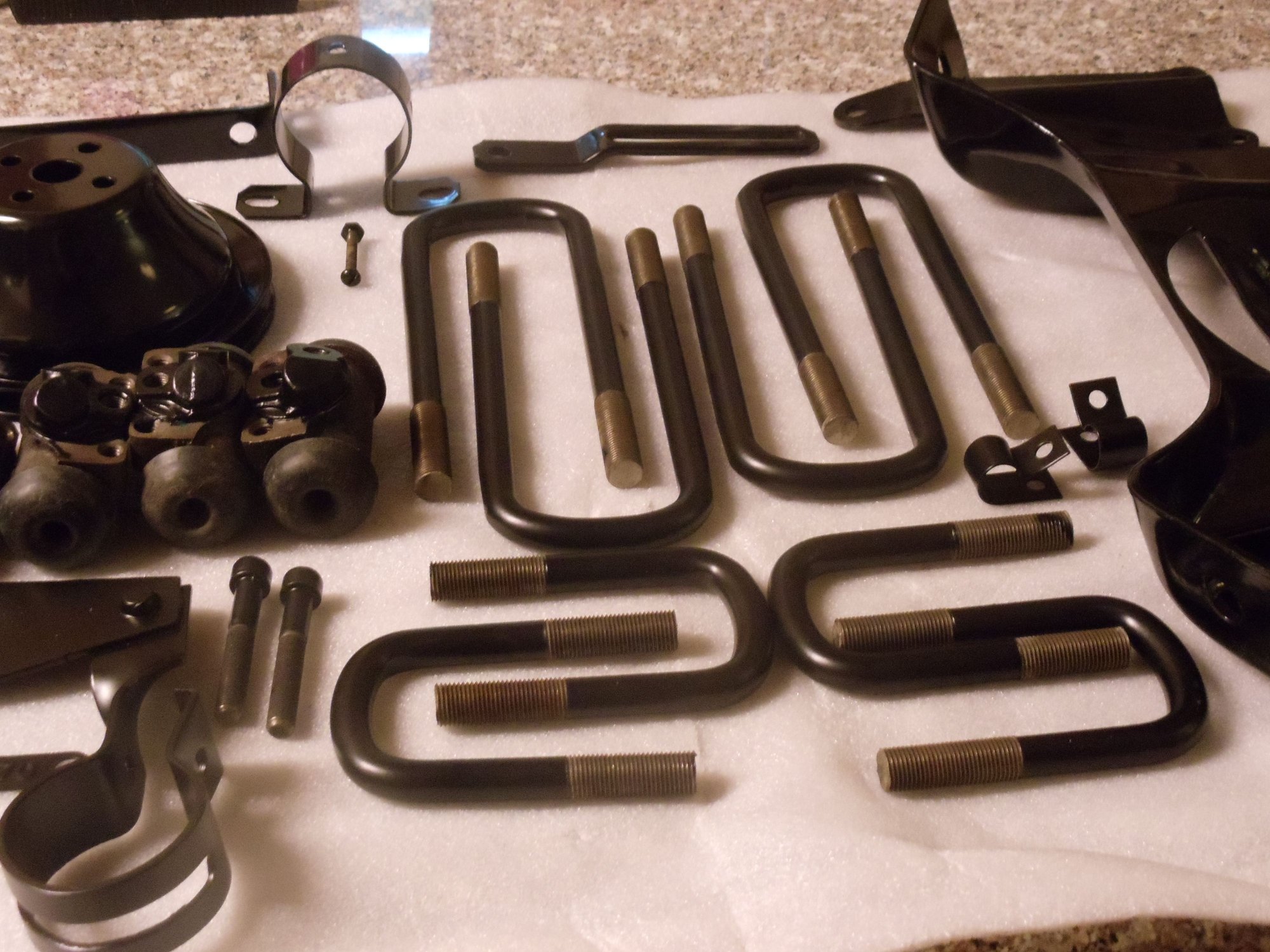

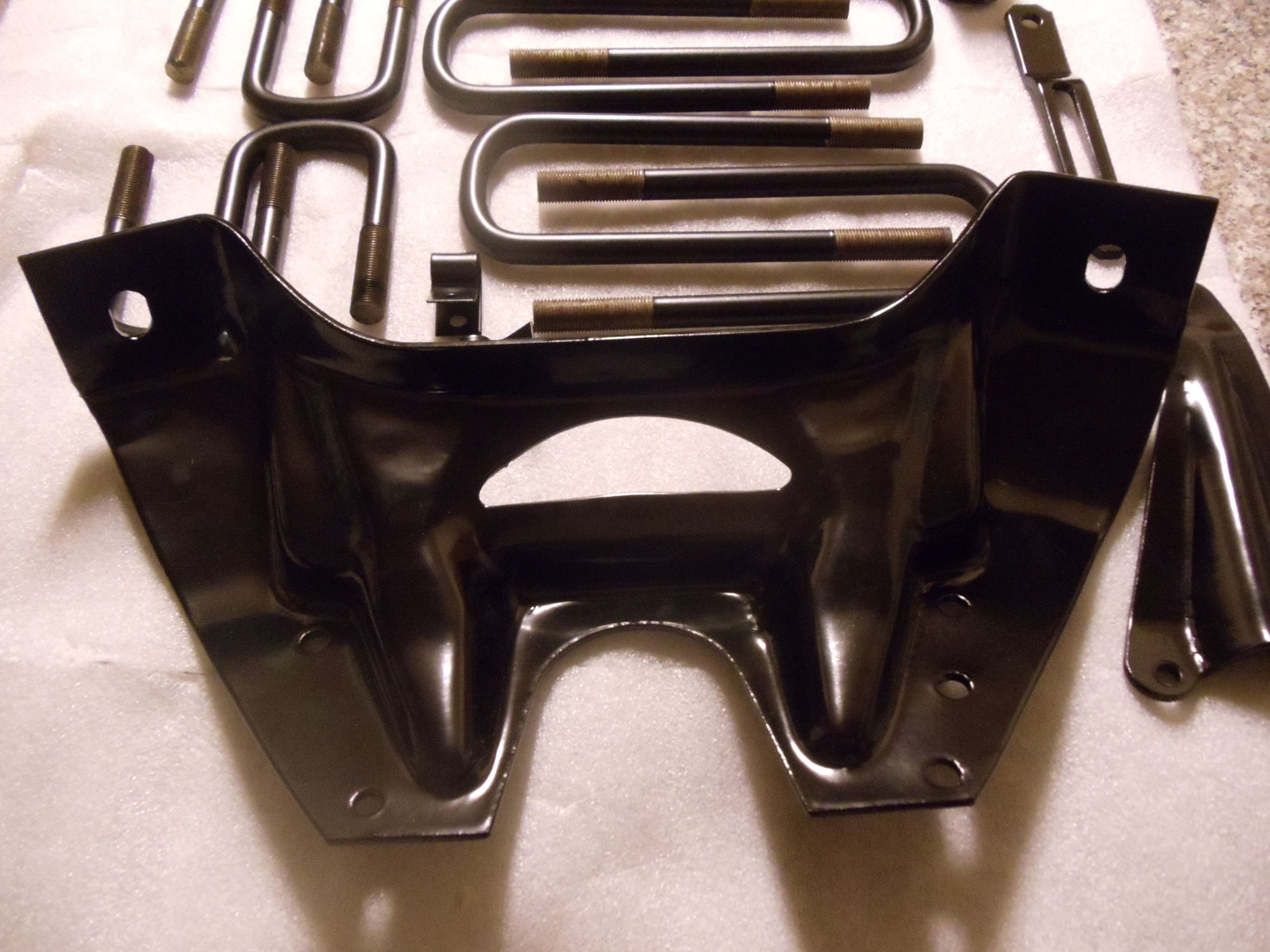

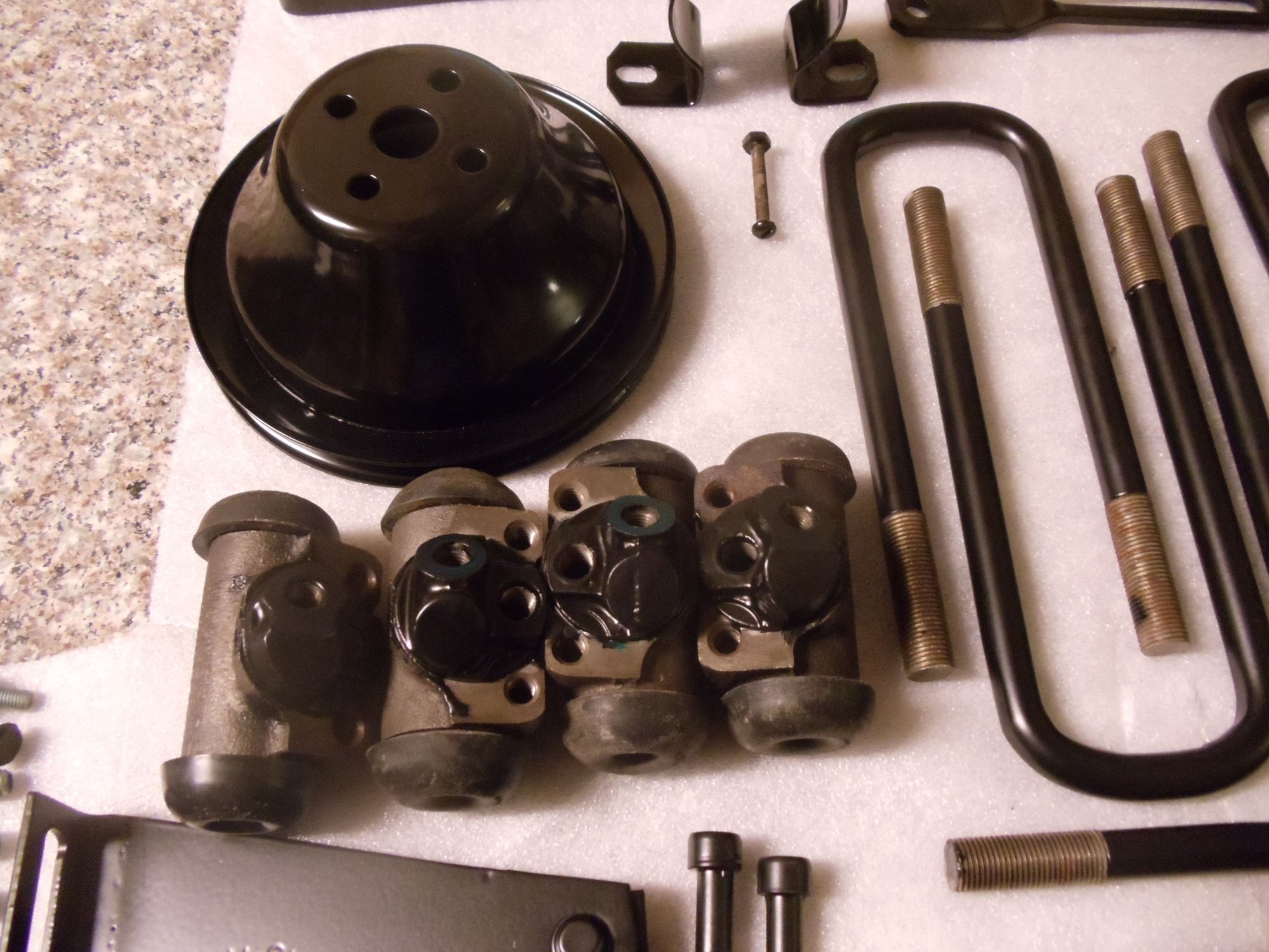

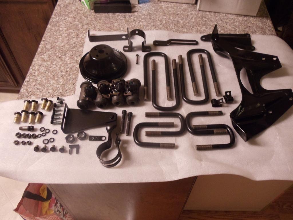

Old Aug 17, 2014 | 11:00 AM
  #180
transam525's Avatar
transam525
Joined: May 2001
Posts: 356
Likes: 14
From: California
Here are some long overdue photos. The parts just came back from powdercoat. Stay tuned for some more before/after photos as the final parts make it onto the chassis.
