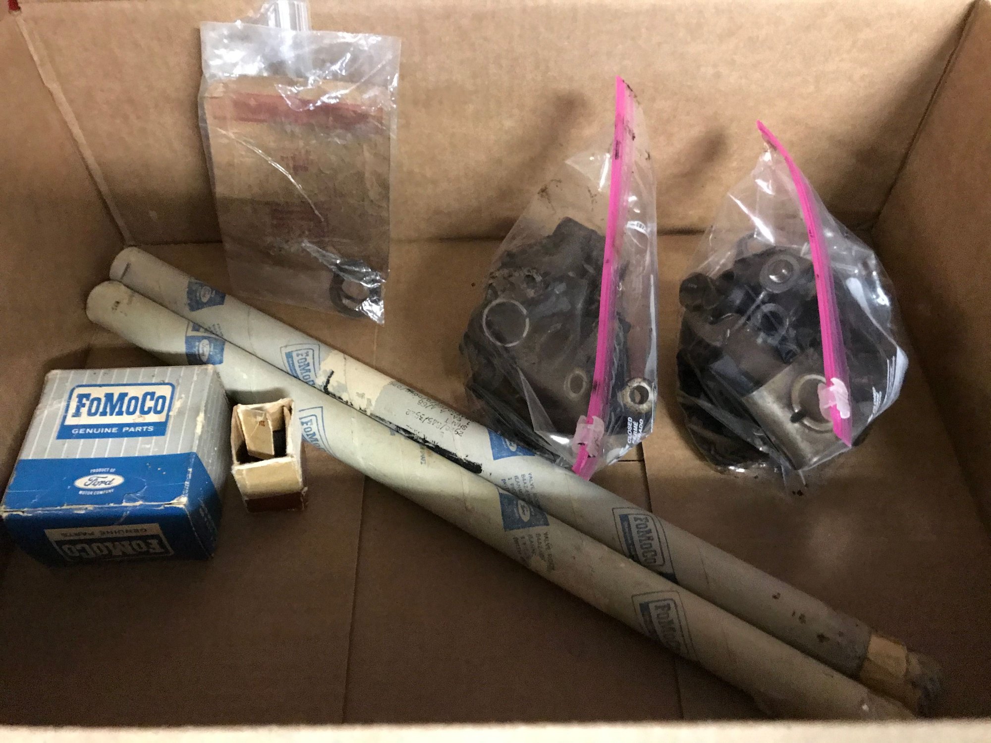

Rocker shafts disassembled and ready to go out with NOS Ford parts for cleaning, machine work/restoration, and rebuild.

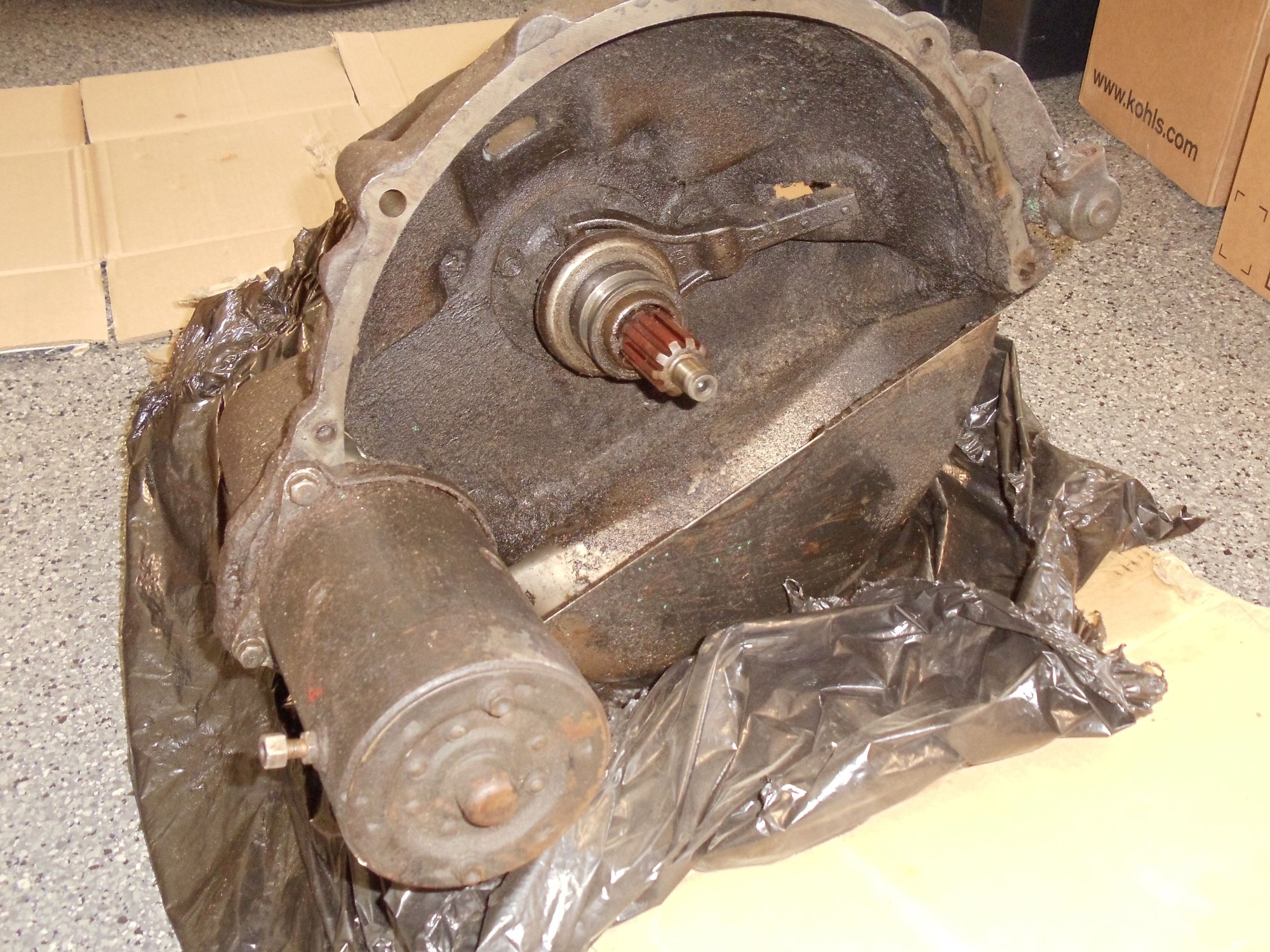

-Separated starter, transmission, and misc. attaching parts from bellhousing

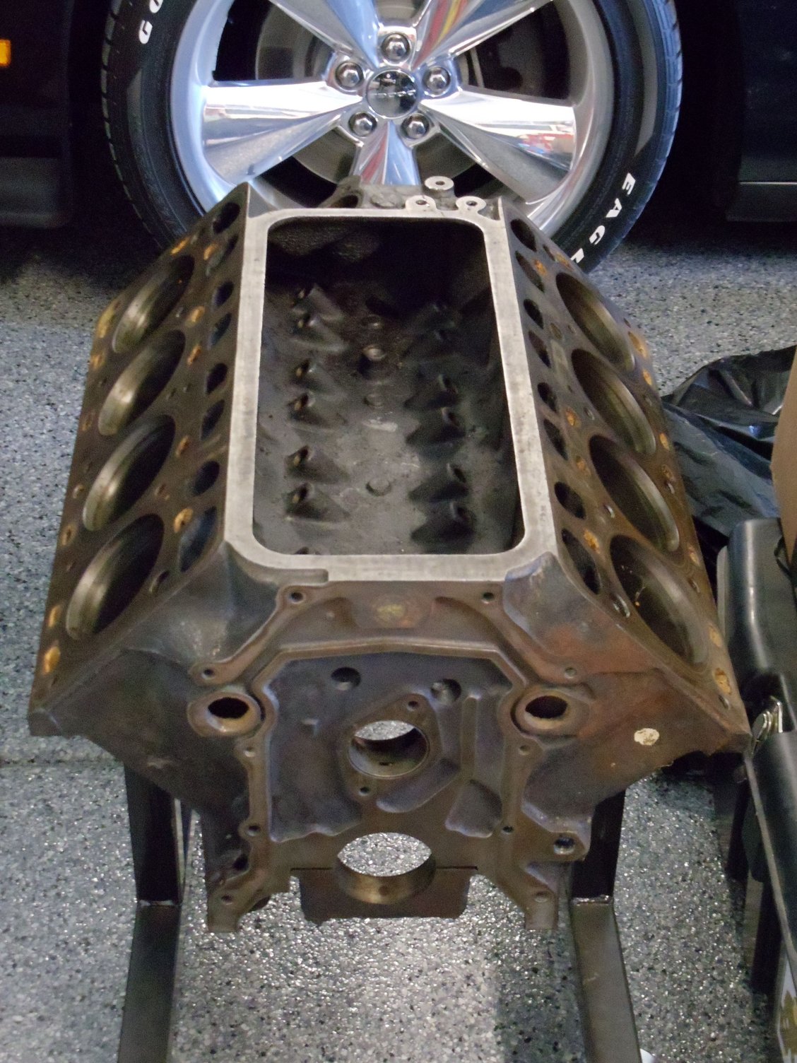

Engine block awaiting the machine shop. Look closely and you'll see the original factory paint markings on the deck and front. Assembly line workers wrote piston fit size on the deck for later install. Not sure about the white dot on the front (likely to indicate 292 or truck use):

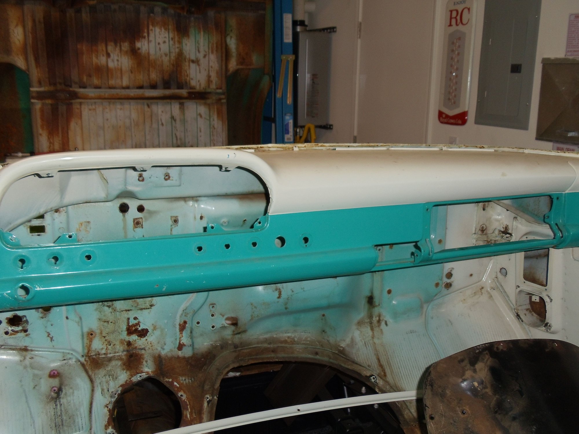

Cab stripped of all parts and ready for dipping. Interior paint is 1960 factory original.

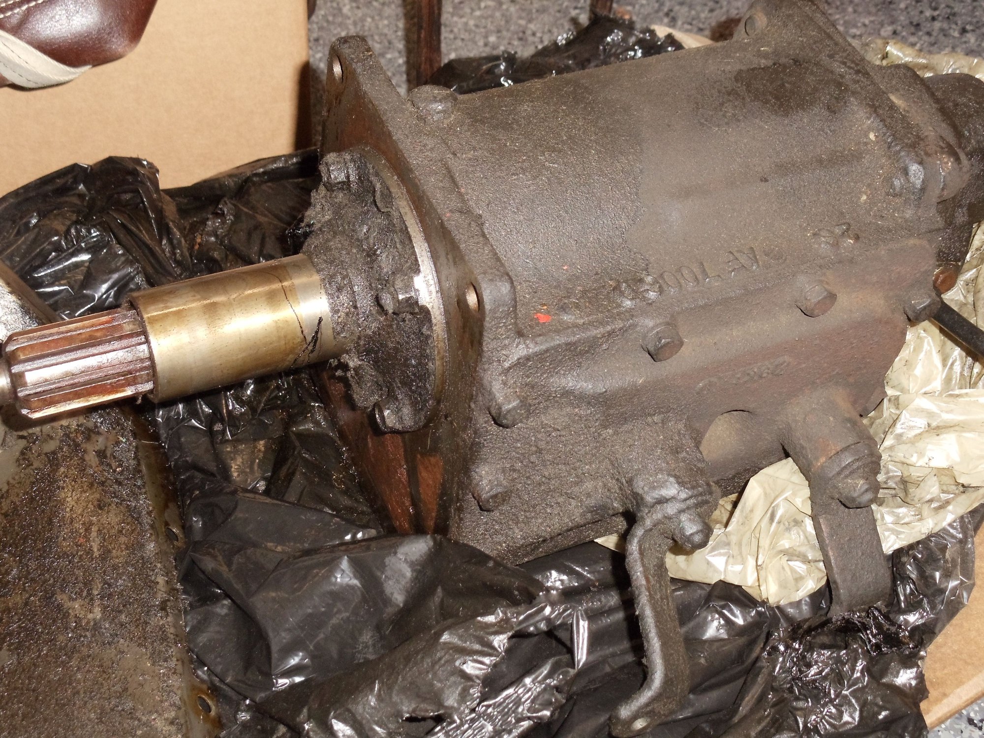

More disassembly--all original components (except speedo cable) right down to the 1959 date coded throwout bearing:

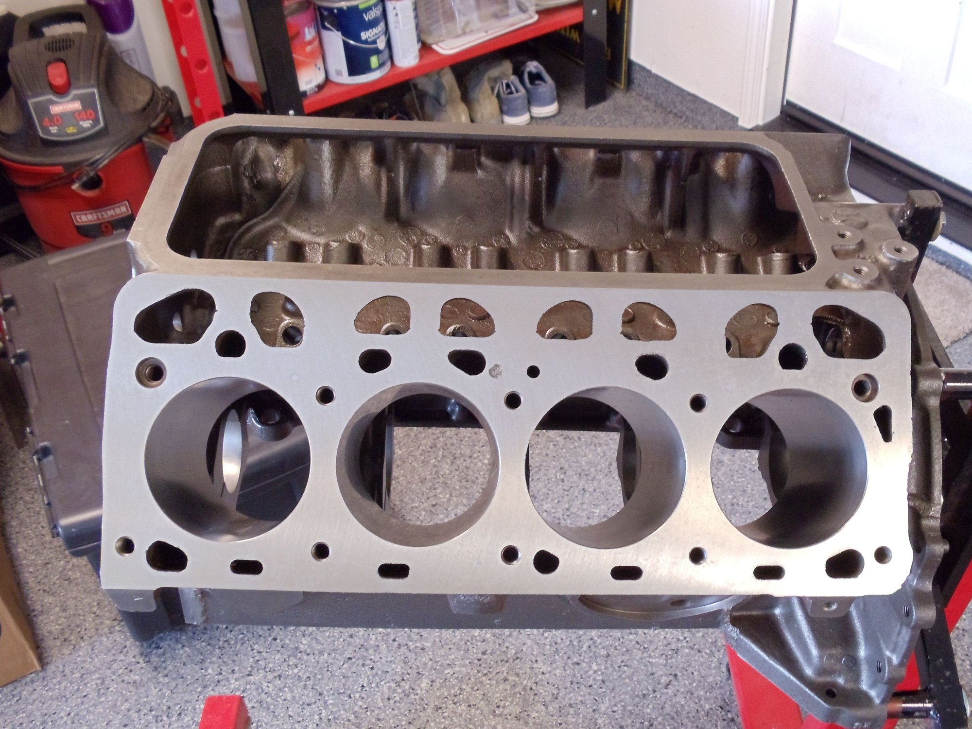

-Engine block cleaned, peened, magnafluxed, and machined. No unforeseen issues with any of the original re-use components and all bearing, thrust, gap clearances were perfect.

Engine block after machine shop.

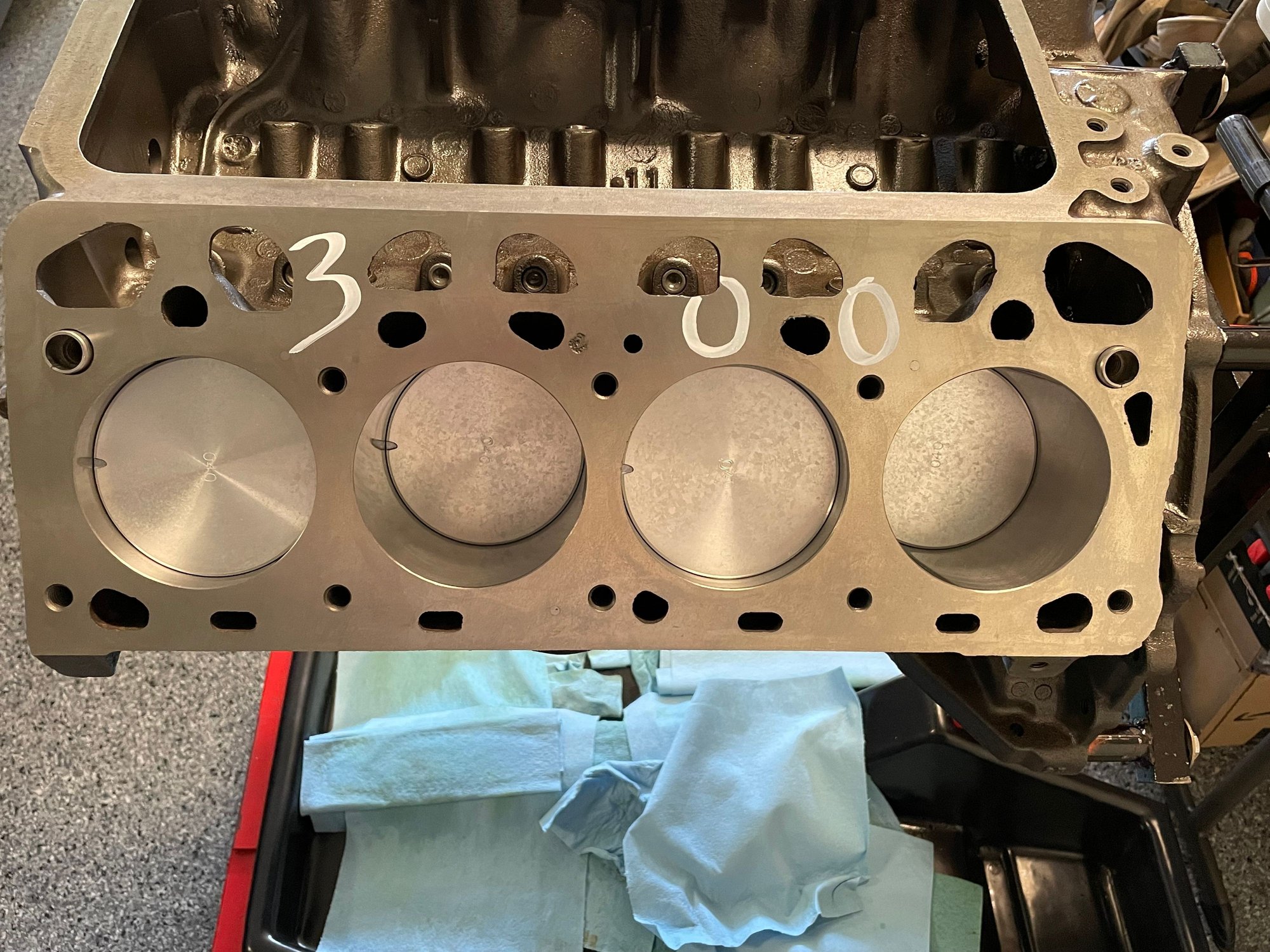

Pistons, rings, bearings, and re-condition original connecting rods installed. I found all these original assembly line markings during the tear-down and decided to replicate them. According to original assembly line video footage, the markings were annotated during the post-cylinder machine inspection process. Their exact meaning?...don't know...maybe the inspector's employee ID, inspection date/time, or the score to the baseball game for those downrange on the assembly line.

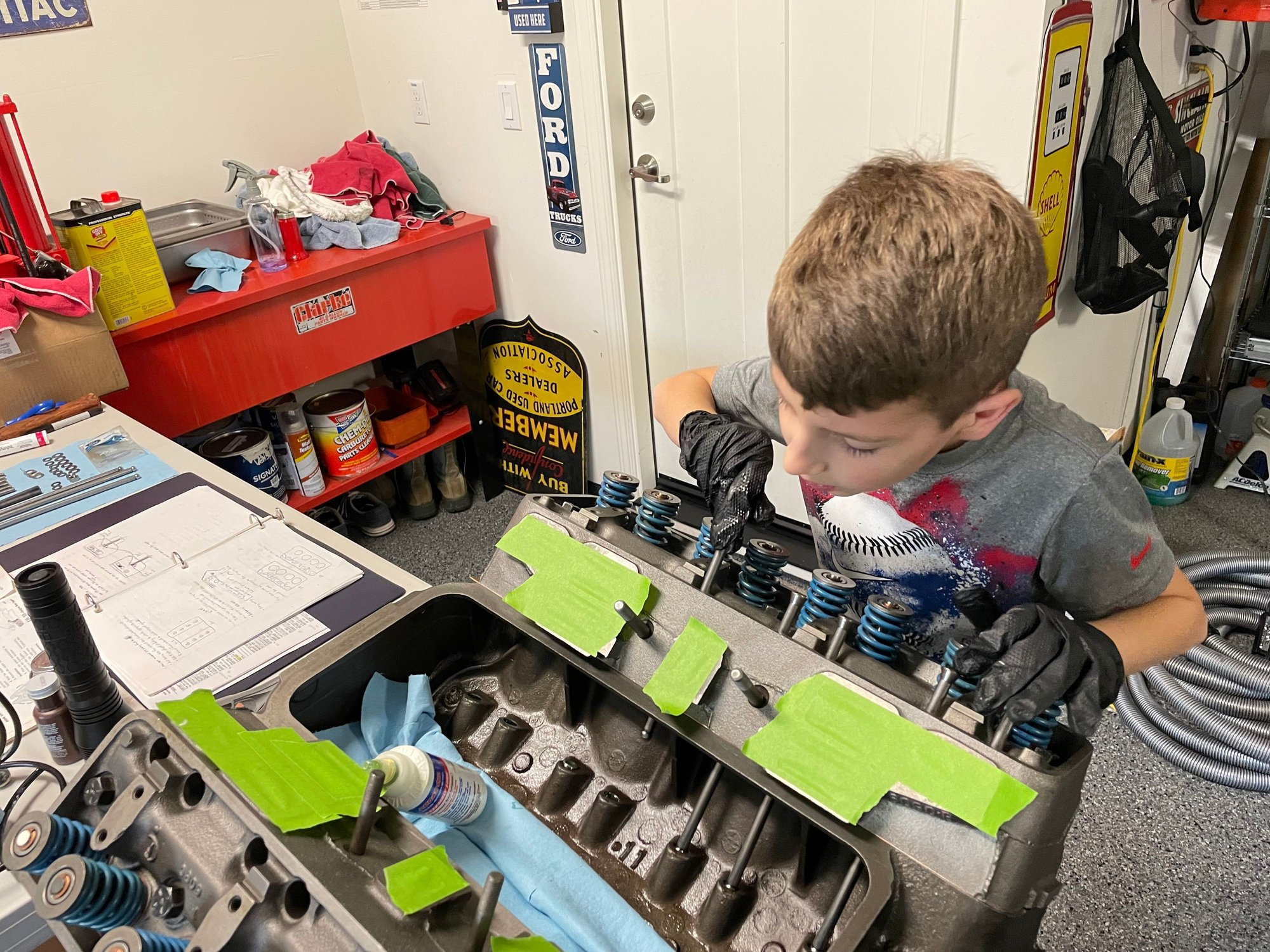

Rocker shaft assemblies (with all NOS Ford parts and restored/machined original arms) installed with restored original hardware, NOS Ford oil tubes, and new pushrods:
My assistant engine builder, who helped with the entire build process of an engine 56 years older than him:

You know, all those pics are great and so glad to hear an update and great progress and all but! Those last two pics are worth a million dollars! Super great to have the young lad involved and giving him the gift of confidence. Way to go Dad!
