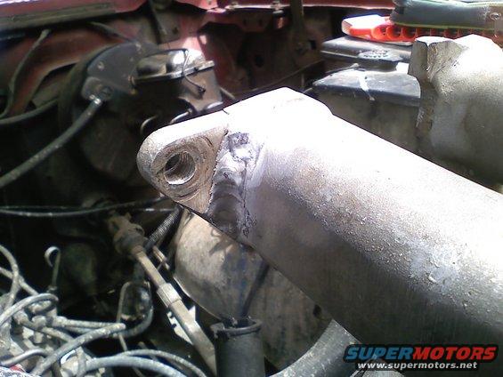

Been waiting to install it since I got my intake fixed and welded. The guy also widened that trouble tab while he was in there, and then planed the intake. $65 all said and done. The widened tab really made a difference when installing.
He did quality work at welding it:
I'd definitely recommend the Mr. Gasket 260 over the generic Felpro one most auto parts stores have in stock, and over the Clifford one, which gave out and broke my intake. It's thick and seems to be of really nice quality. I liked it.

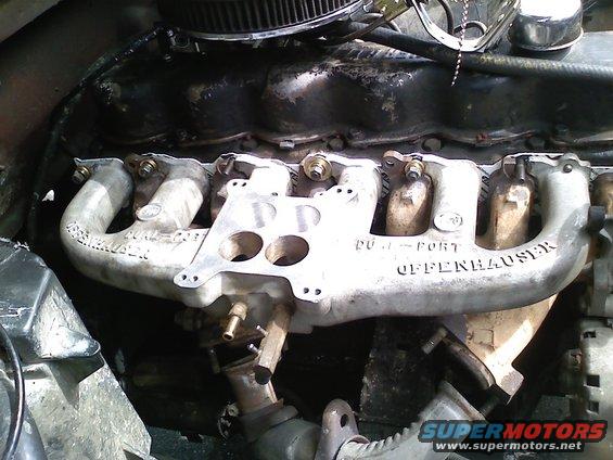

This time, I decided to get some new washers, instead of using the 30 year old thick springed steel ones that were on there stock. Coupled those with some high strength split washers, and it seemed to really press the intake/exhaust on there nice and tight. 25ft/lbs per bolt.
It still seems to want to buck and kick though. I sprayed all around the intake and carb with carb cleaner and it didn't seem to make any difference. Seems the intake is all nice and sealed and we're off to find another cause of the idle issues. The exhaust is still popping, the vacuum needle bounces between 18 and 19 when it's idling, and I can feel and hear a slight buck when sitting in the cab. Not sure what it is, but maybe I can now rule out an intake leak.
However, seems to have helped quite a bit in other areas since it doesn't bog off the idle quite like it did.

That 1st pic shows you re-engineered, again, better n ford.
