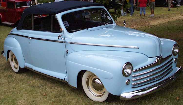

Here's a pic of a 47 car with the same caps as out trucks:
This is a late 1947...which uses 6A-1130-A hubcaps with blue FORD block letters, These hubcaps were also used on 1948's and 1948/52 F1's.
1953/56 F100 hubcaps (BAAA1130A or B3C1130A) look similar to 6A's, but are not as deep. This is why the OP has a mis-matched hupcap. The FORD letters were painted red.
These hubcaps were not used on Passenger Cars.
Early '47 Passenger Cars look just like 1946's, have rectangular parking lights mounted on the fenders above the grille. The grille bars have indented scallop lines which are painted red.
The hood front emblem, hood ornament and side mouldings are also different. See page 79 in the Standard Catalog, two early 1947 Sedan Delivery's are pictured. The 'front clip' is the same as the cars.
1946/early 1947 hubcaps have FORD block letters in red with three red hash marks above and below. These hubcaps were also used on 1946/47 Sedan Delivery's.
I once owned two early '47 Woodies, an early '47 Deluxe Club Coupe, an early '47 Sportsman and three '56 F100's.

That's Excellent info Bill!
So my guess about the difference between cars and the later trucks was pretty lucky!
And the shallow one is the F-100 hub cap - that's interesting! Was there a reason for that?
