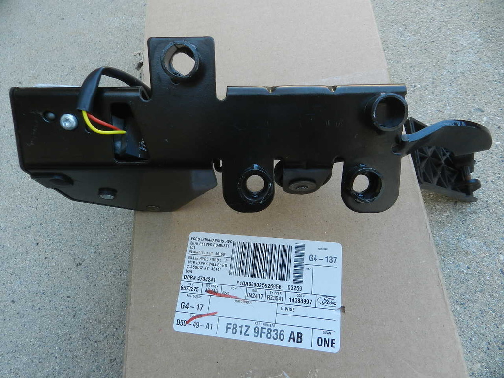

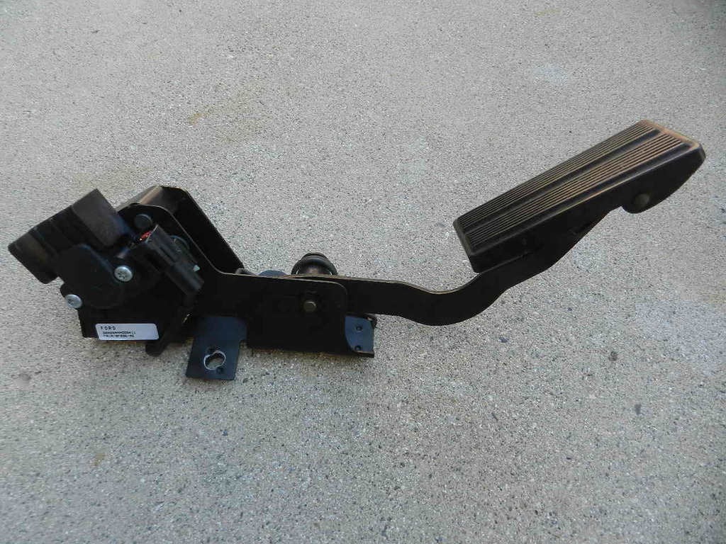

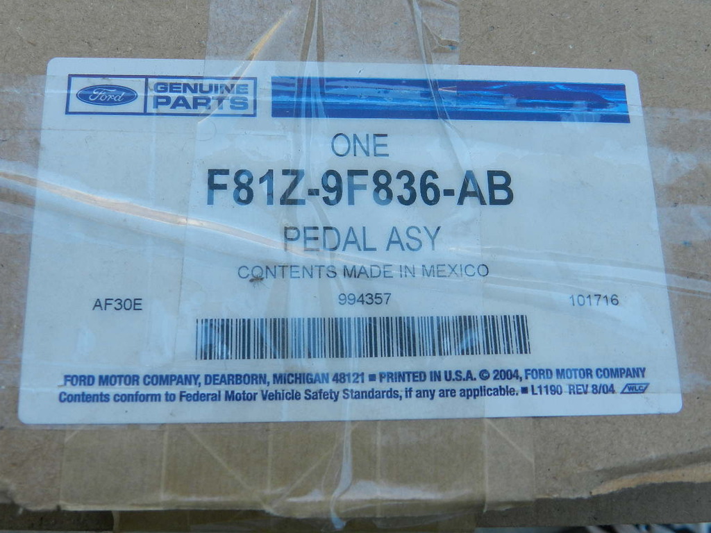

Note: I didn't have any dash light issues like the person in the video...only the no throttle response for me. If you read my previous posts, you'll see that I did swap out my original TPS for a new NAPA unit and the problem persisted. I'm of the opinion that the IVS was the culprit and that can only be changed by installing a new pedal assembly.
The red and yellow wires in the photo above go to the Idle Validation Switch (IVS).
