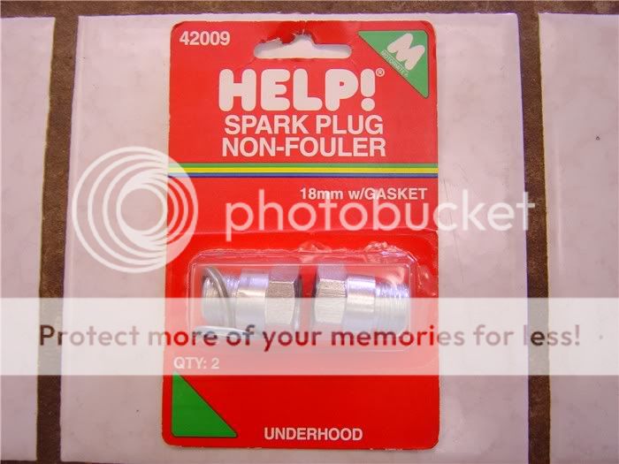

They used to make an adaptor that was to stop oil fouling, it was basically an extension you put on the plug, Check at the auto parts store and find an old parts man. It will work till you get the engine fixed.
I have an extra 460 laying around that has a set of those in it. Never have fired it up to see how bad it smokes.

Originally Posted by montana_highboy
I used those in 3 cylinders in a 390 that was in my 1964 Mercury Montclair YEARS ago.
It did take longer for the plugs to foul but they still fouled.
I carried a spark plug wrench and a wire brush to clean them off when the did.
That was one tired old 390.
