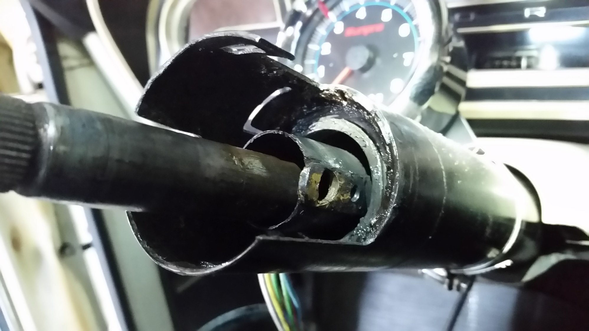

Replaced the worn out shift tube didn't bother to replace the plastic bushing on the tube new shift collar and she shifts like sliced bread...

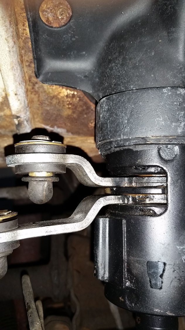

Originally Posted by jowilker
When it hangs, lift the hood and ****** the arm closest to the fire wall upward to free it up.
Slightly pull the shifter towards the steering wheel lifting it out of 1st. let it fall completely in neutral towards the dash,
and with a very slight pull back again lift it into 2nd.
See if that helps until you can get new bushings in.
John
Thanks jowilker for this tidbit of knowledge, I'll definitely give it a try.
I will also be getting the kit# C5TZ7343A that Number Dummy suggested.
