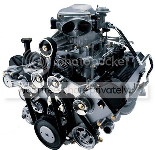

Where/how does the alternator bolt on? It looks like the pulley assembly sets where the alternator once bolted up.

The pulley assembly sits far enough forward for the alternator to be in the stock location. Here is a picture for visual reference.
