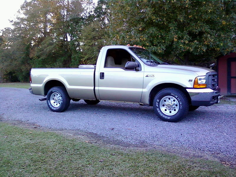

Thought i would share....We have some neat plans for our new project Tow-Haul over the fall/winter.. Stay tuned .... as i will be updating this thread as we make progress..
Specs are :
shes all stock... 2000 F250 xl 2wd auto 66k org. miles... with of course the V10

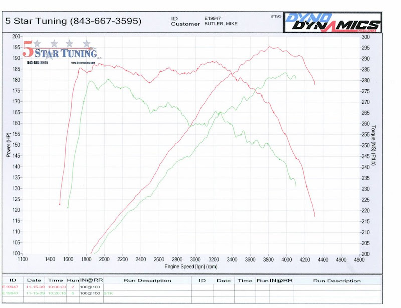

(Green) Bone stock vs (Red) 87 octane tune... Graph is choppy as i narrowed Y axis a bit to see the variance better.. Truck has 3.73 gears and is strong and quick being a 2wd..

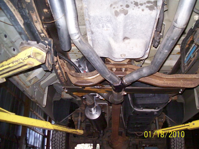

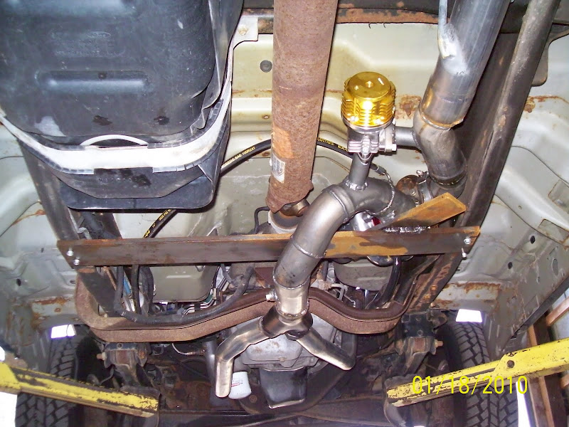

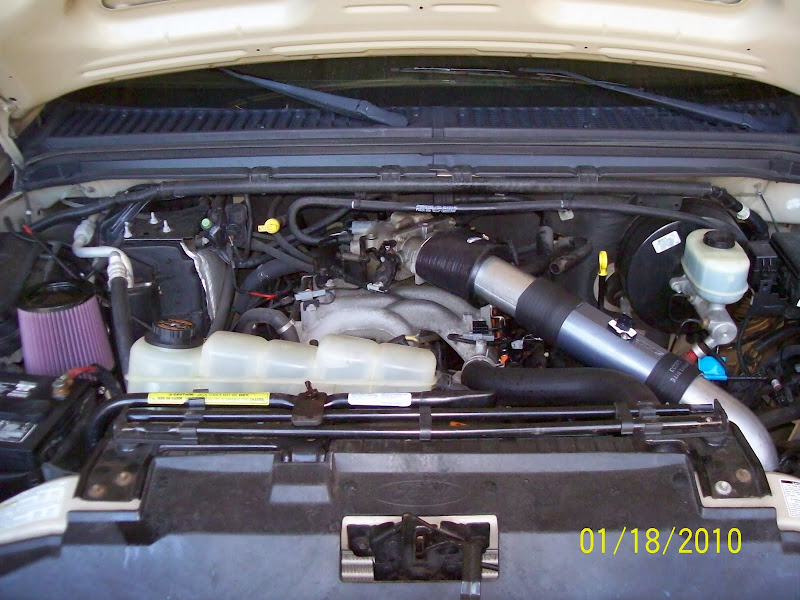

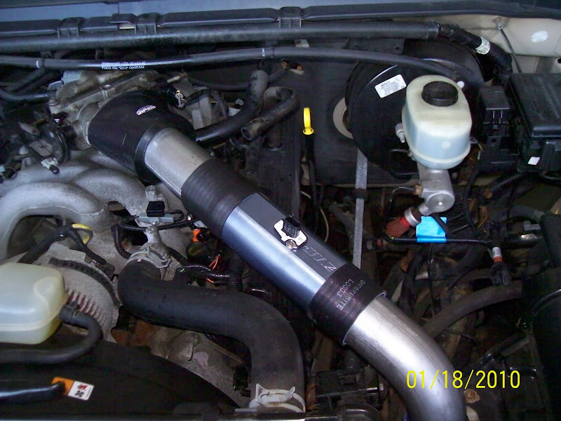

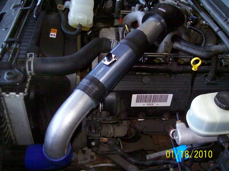

Hi All
Just wanted to update this thread. A couple of months ago we started fabbing up a low boost single turbo for our tow / haul project. We have a ways to go before completion. Nothing real pretty but should be very functional. There are some things we will be changing most likely. Cost and Ease of installation is the blue print behind the build up. I did not set out to have turbo location undertruck but seems to be best for install and costs but may prove better to fit other vehicle applications in the end. aka 2wd,4wd,5.4L motor and maybe Eseries vehicles. Have to start some where right?
I am hopeful that once final fabbing,tuning and towing testing are complete; we can maybe offer them as a kit of some sort to the public. Not sure when that would be. This build up is strictly about hauling and towing performance.

Mike,are you using the PSD intercooler?
That's what I plan on doing whenever I get around to my turbo project.
JL
Old Jan 19, 2010 | 07:54 AM
5 Star Tuning's Avatar
5 Star Tuning
Former Vendor
Joined: Sep 2000
Posts: 2,627
Likes: 76
From: South Carolina
10-4 its installed in the pics. It installed just about perfect like factory. And it was cheap.
I thought that's what it was. Cheap,effective,and fitament can't be beat.
I'm intrigued by your work here and will be watching closely.
JL
