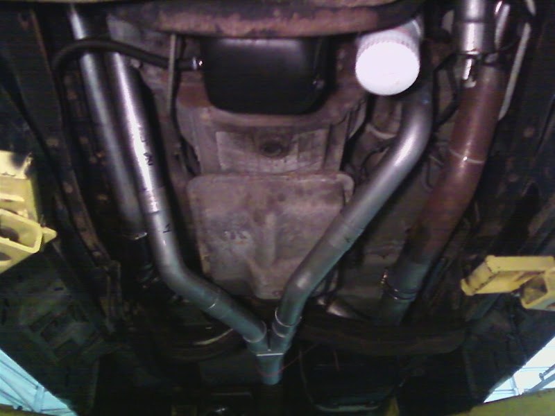

Hi Thanks for asking
With all the delays on sending turbo out for repair we decided to take a step back and rework some of the piping to make it more universal for 2wd and 4wd Superduty trucks. We are also going to mount the turbo a little different than what we had originally planned as well. Its been a long project no doubt but from what i have driven it , it will be a solid improvement for those looking for more towing power be it in a Superduty truck or RV with the V10.

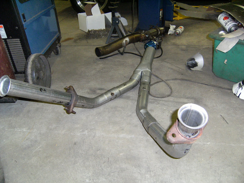

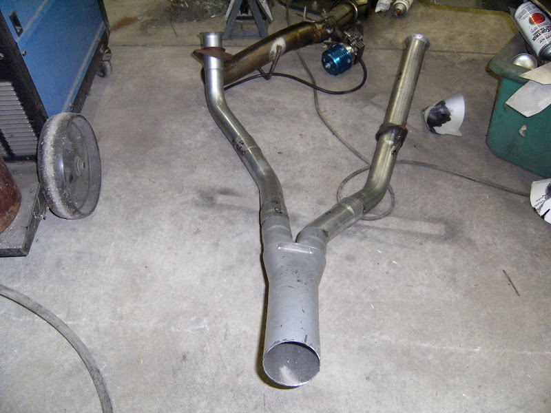

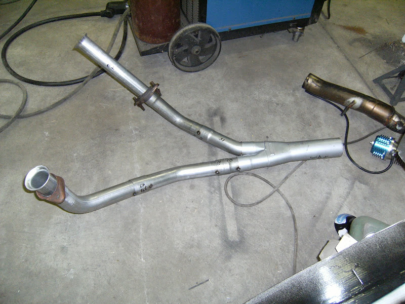

Small Update!
Here is the universal ypipe that should fit 2wd / 4wd 6.8L and 5.4L.
