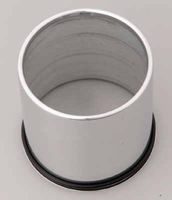

was just happening to think last nite what size lugnuts would i need and would i need to get a chrome center cap for the front so i can get at the hubs.

dont remeber lug size but on my '06 had to forgo the cap up front to use the lockouts.

I'm not sure what diameter you need, but MT sells open center caps.
Mickey Thompson 101215 Center Cap Push-Through Open End:eBay Motors (item 370283006714 end time Nov-06-09 14:21:29 PST)
