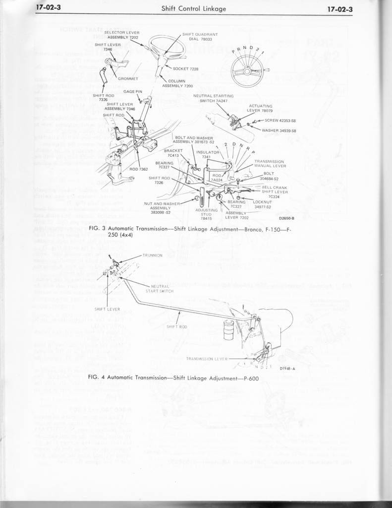

From the 1978 shop manual vol.1 group-17- automatic transmission.
I believe you fellas are looking for "bearing" 7C327?

Originally Posted by F-250 WARHORSE
that is it. How do we convert that to part number? and search. Thanks.
It's the WRONG BUSHING! Someone else came up with it, see post 26. I told him he was wrong and now I'm telling you.
The only trucks that used this EOSZ-7C327-B (replaced D5AZ-7C327-A & EOSZ-7C327-A) bushing: 1973/76 F100 4WD
The thing is, I posted the pic twice and you don't see a bushing besides EOSZ-7341-B .. More than likely it was only serviced with the bellcrank.
See EOSZ-7C327-B (replaced A) applications in parts catalog pic below.
