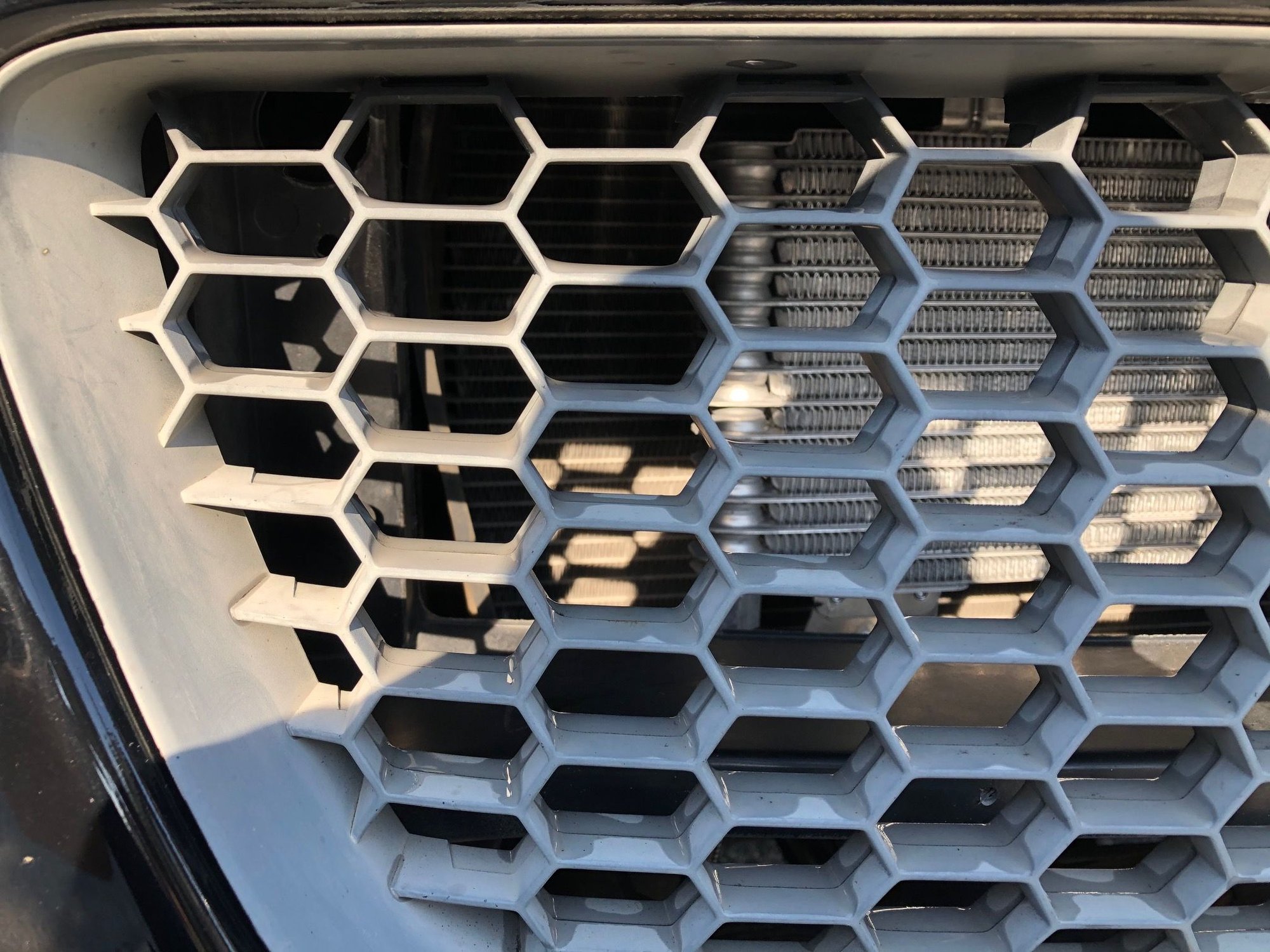

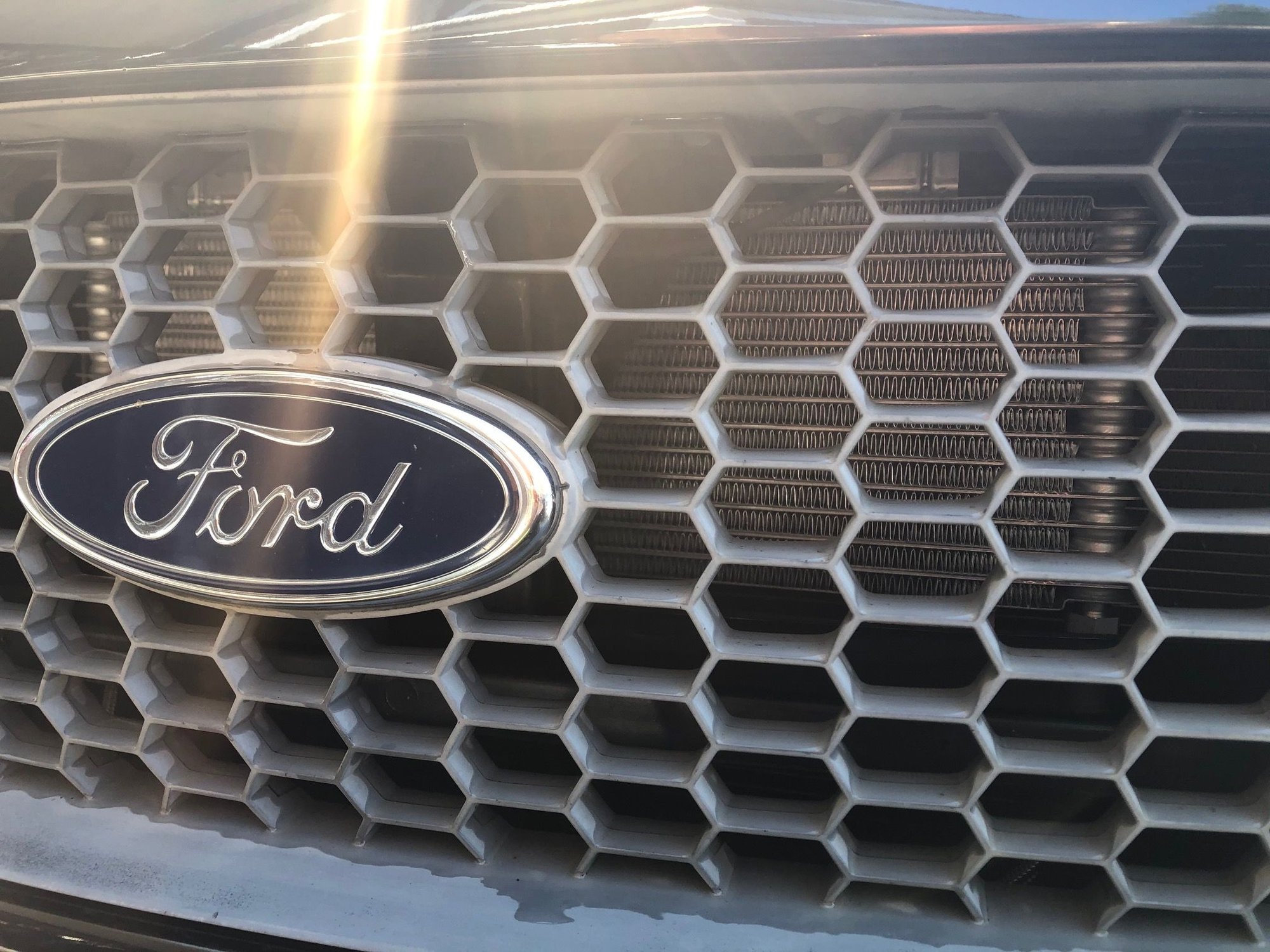

Thanks for the reply. I put a V10 cooler on the 4.6 2000 F150 last year. Threw out the stock cooler.
I moved to a hot climate and did the upgrade after seeing others do it in similar hot climates.
I was looking at the 6.0 cooler but it didn't look like there was enough room in there.
With the stock cooler on the 10th gen Fords. It is a bit over 2" thick but it's surface area is 11" width and 4.5 " height. It's thick !
Now is it the surface area of a cooler that affects cooling or does thickness of cooler come into play as well.
I have been hauling 2200 lbs in the bed for a lot of trips, felt the transmission lines going to cooler and it didn't even break a sweat. I think I'm far from running hot.
here are pics of the upgrade.

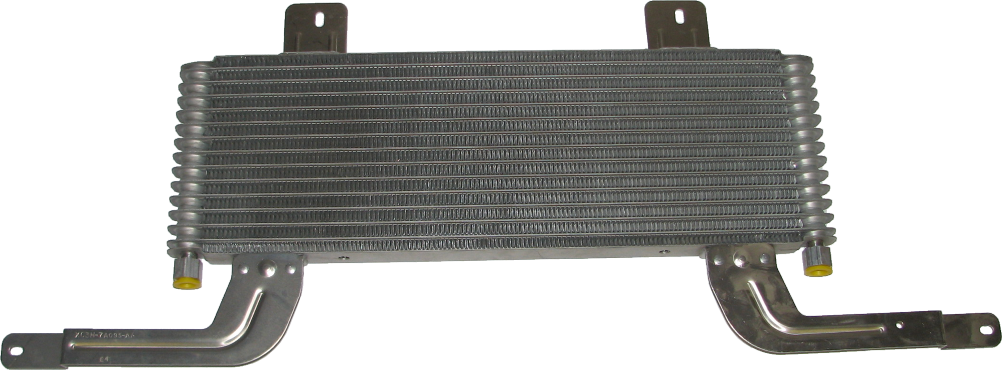

This was the stock cooler on the 10th Gen....
thicker compared to the V10 cooler. But the V10 cooler has more surface area.
