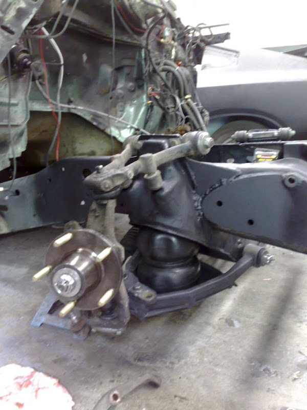

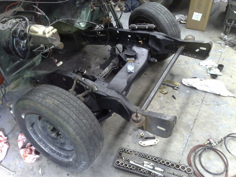

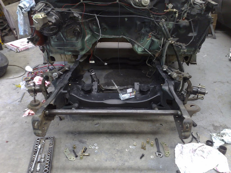

I'm replacing mine with a Series III Xj6 Jaguar IFS front end, setup for air bags. Rack and pinion steering is a bonus.

brewtl,good job!I see u have alot of time in it.Looking at the pictures it's going to be right hand drive?Can't wait to see when it's all done.Keep us updated

brewtl,looking at your pictures i see the truck is right hand drive.Thats cool.I have never seen one before.I LIKE IT!

Yeah, RHD, I'm in Aus. Jag made these LHD too, in fact the LHD rack mount in still there on the cross member
