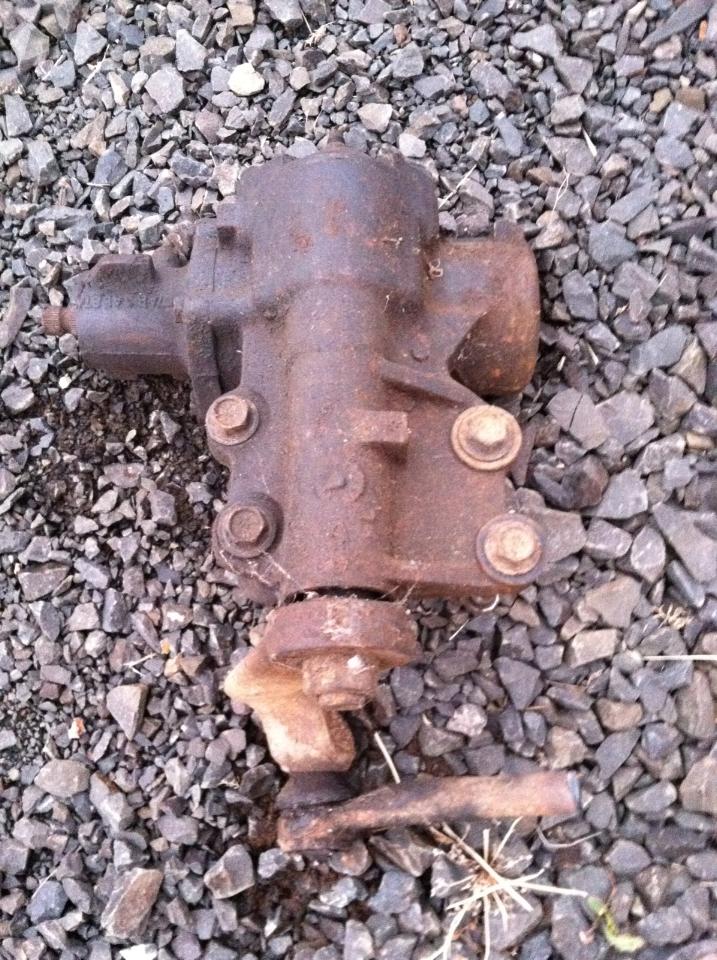

bringing back an idle thread
I'll be picking up this gem later on in the week. It's from a 79 F350. The gear box and pitman arm are included, I will have to purchase a drag link.
Would it be worth while for me to rebuild the gearbox while it's out of the vehicle?
Attachment 293023
I was looking at RockAuto for "drag link" and pulls up "center link". What exactly is a "center link" vs "drag link"? Are they the same? The two images below are ones I pulled from the site. I prefer moog, but depending on the price, i may just go with Raybestos.
- Raybestos #4351037B
- Raybestos #4401005B
As always, all HELP is appreciated. Thanks in advance.
