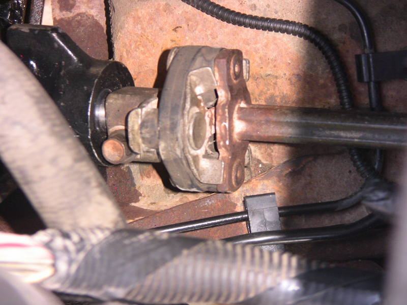

I haven't read through this whole post, but I didn't see where anyone has checked the steering wheel shaft joints or to see if there is any play in the shaft somewhere else.

From: Millersburg, OH
Besides the tilt steering joint really the only place that I can see any play happening in the steering shaft is right where it goes into the steering box there is a rubber "shock". Mine was still in good shape after 9+ years.
Attachment 15672
Yes, that's where the Redhead person told me to check. My problem is definitely the steering box, but he said check that too and fix if necessary. He kind of elluded that he's seen a few bad ones.
Old Jun 11, 2009 | 04:28 PM
  #120
Monster-4's Avatar
Monster-4
Joined: Aug 2007
Posts: 3,974
Likes: 18
Yeah I could seeing that. It's rubber with metal pins so if the rubber gets hard it would tear real easy. I could even see it tear from stress at full lock and hitting a bump or something else like this.
It's real easy to check just slid the cover up and it's right there so good point on spdmpo checking this.
