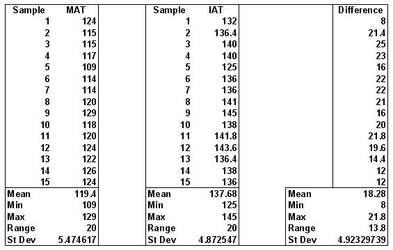

Originally Posted by Bigcat350
So I guess this extra heat under the hood could hurt the performace?
That is a subject of much debate. I am not saying Ford put the foil there for heat protection. I am saying the CAC system is there to reduce the charge air temperature and anything that aids that simply aids that. I have seen what heat soak did to my engine on the dyno. Not having an aftermarket intercooler, I am going to insulate my CAC tubes as my EGTs really aren't a problem in my application and how I use my truck.
What I need to decide is how much datalogging I want to do to prove this out.

Mike --> Do this. Log some data showing IAT & MAT, like you did a while back. Then go wrap your pipes, and do it again. To be fair, do it after the truck is fully warmed up, and try to make both runs around the same outside air temps/humidity. It won't be exact, but it should show any difference. Remember the graphs I posted back when we were talking about this before? If there is a significant difference, we should see it. Here is the graph I did before:
EDIT: So if there is a noticeable change, the "Difference" line will get higher because the MAT should get cooler. My prediction is that it will be a wash. Also, I can go check my other PC and see where I put the original spreadsheet if you want it, Mike.
