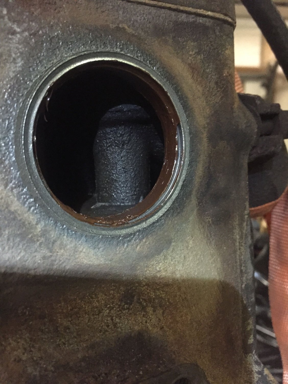

I found the large 2-1/16 inch concave (Welch) expansion plug in brass at goodson.com. The part number is 96-2062CCB. They are about 4 bucks apiece. I believe it is made by QualCast. This plug is the large one at the back of the engine that you don’t want any trouble with. I dealt with a Danielle. She was very nice to deal with. They did not list a 1-5/16 inch brass concave expansion plug.
Nelson
Update: I have removed the bell housing and revealed another expansion plug (see pictures). I believe this one is for removing/installing the cam shaft. The upper one appears that it will take a 2-1/16” concave/Welch style or a 1-15/16 cup style. I would strongly suggest a nice film of Permatex No. 1, the one that hardens.
Here is the upper expansion plug on the back of my 226H engine before removal. If you zoom in on the picture you can see the size stamped into the plug; 2-1/16”.
Here is the plug removed. You can see the hole that is revealed is machined.
Here is the new brass 1-15/16” cup style plug.
Here is a picture of one of the freeze plugs on the side of the block. You can just make out the size stamped into it; 1-5/16”.
Here is the lower expansion plug on the back of the engine that I believe is for installing/removing the cam. I did not replace this as I figure being exposed to oil and not water it will never corrode.
Nelson
