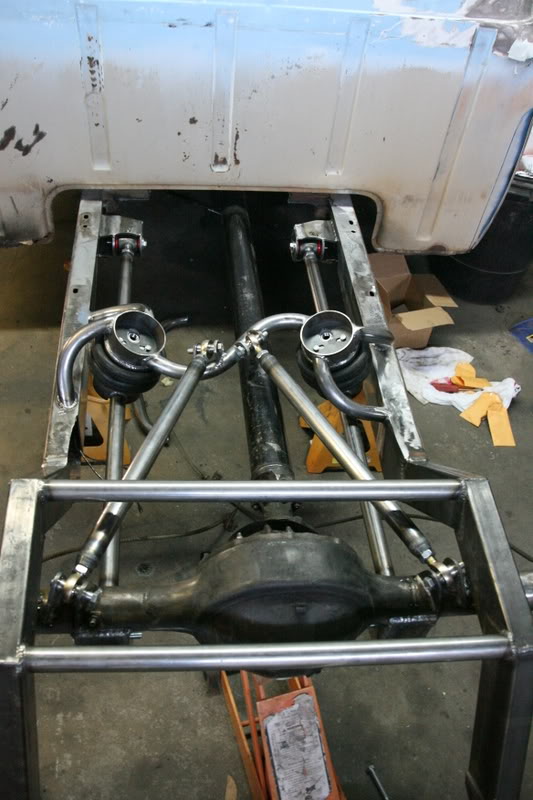

an update finally.
heres some photos for oyu guys.
the 4 link is finished, and everything is welded in. These pictures are from during the whole process so some are of things tacked in place in such, b ut you get the idea, and a few extras in there too.

From: Benton, AR
Nice gas tank. Some people will bitch, but thanks for posting your pics on the thread so I don't have to jump over to your gallery all the time.
On the 4 link, I thought that the bags went on top of the axel, but I see they are further up. Does it affect the ride having them there? Do those rods have enough strength so you could still use it as a truck?

yeah those are 1/8th wall DOM tube, stronger than ****. But the lower links are going to be braced by another peice of 1/8th wall 1.5 OD as well, so they are rediculously strong.
over the axle bags are really typical and they work just fine. There is nothing wrong with that set up. A link bar mounted bag is just better. You get a better ride, more lift, amongst other things. Thats all we do at our shop, no over the axle jobs.

Brandon where is your shop, I'll be right over. I finally looked from home. You do some nice work. Do you angle the bags in for a reason other than it looks cool? I like the bag mount crossmmber. What kind of front end will be under it when your done.

yes the bags are angled for a reason to get more lift, well in theory. Because if the bag is at an angle the smallest part of the angle is going to lift to its fullest potential because of how a bag works. BUT, it is somewhat restricted by the other side of the bag maxing out. really mine are angled because of frame clearence and looks. Something is wrong on my 4 link though. But i was just happy to have it finished i didnt bother messing with it today. Ill play with it tomorow. It wants to pull the axle to the driver side.

I don't know jack about fabricating, but as my previous question asked about placement of the bags, it looks like they are pushing in different direction( to the side and down). Sounds like one of them is winning. Just a guess on my part, nothing more. You may not have a problem when you actually have rubber on cement though.

well the bags havent had any pressure to them yet so it cant be that. I think that my 4 link is all out of wack adjustment wise. Either that, or my tab idea on the cross member is going to have to be modified. eventhough i like it how it is now.

im pretty sure its cause the upper bars... the way it is now makes em unequal and its gunna have em fightin with each other. it looks cool, but i dont think thats gunna work.

no idea what a mazdawg is BUT. the upper bars work fine now, they just needed to be properly adjusted. All is well now. But i bent my link bars a little bit playing with it. SO today i straightened them and ill have photos of the new/reinforced lower links
