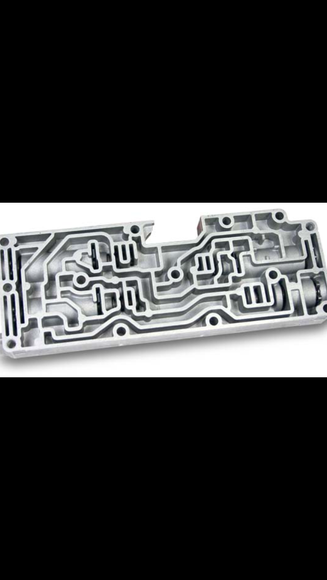

sorry new to this forum couldnt find the how to on this mod anywhere youtube etc i would appreciate it if someone could direct me to the instructions or tell me how to do it
Let me see if I can find the pics I took. It's not difficult and does help a bit.

That little narrow space is the identifier. 3places like that in the rear most section of vb that goes across the rear. Lots of 8mm and 10mm fasteners to remove. Just drill 3places like that to the 1/16th drill at an angle to avoid the surface next to the target.
Clear as mud? Lol

Make sure you have a good drill. If the end of your drill have any play in it it can cause the hole to be egged out making the hole larger.
thanks thats more than i got anywhere else iou 1
Sorry I can't find the other pic. The three places are denoted like that. It's no big deal once you have done it. Next time I do one I will take pic again.

Is that where you're talking about

Yup. There's 3 of them.
