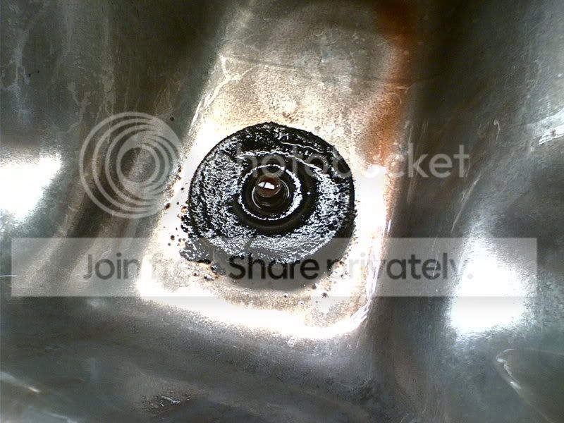

You did exactly what I did -- I bought mine at 60k and just went over 80. Here's what the fluid looked like while it was coming out:
It was nice & pretty red and didn't stink. Just get lots of fluid when you do it -- it holds 17 quarts:

Dang. Now I wish I would've taken more pics. I got tired of cleaning my hands off to pick up the camera...
My pan magnet had some trash on it, but it wasn't that bad. Did your filter come with that bracket or is it part of the deep pan kit to keep it from falling off?
Marc --> I don't know how to accurately answer your question. But I will stick my neck out and say that the *chances* of a longer living tranny are much better if it's well maintained vs. "UH-OH!! My tranny is starting to slip and/or shift funny -- I better do a fluid change!!". And then blame the failed tranny on the new fluid. Like your motor oil, it eventually breaks down, and if it's doing it's job, it carries the impurities away from the "business parts" that inevitably end up in the fluid as a result of them doing their job (clutches engaging, gears meshing, etc). I don't think anyone will argue that keeping your fluid and tranny cooler won't extend it, but it's never a bad idea to change the stuff on the prescribed intervals. 30k is roughly two years for most of us, so $100 worth of Mobil1 at that rate is cheap insurance. That stuff handles whatever heat you do produce better, so it's better in the long run for the tranny. Keeping the shifts nice & short and the pressures where they're supposed to be (via PCM SW, shift kit, or other various methods) will do nothing but extend the life even more. If you can't tell, I'm a firm believer in syn fluids -- all of mine are now syn (except for the brake fluid -- but give me time... ). I think they're worth it based on the way my past vehicles have behaved vs. others that ran dino. YMMV. Literally.
