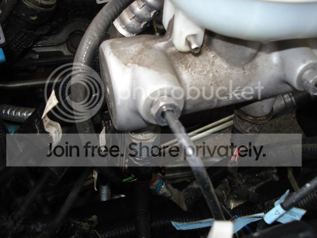

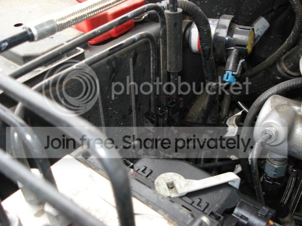

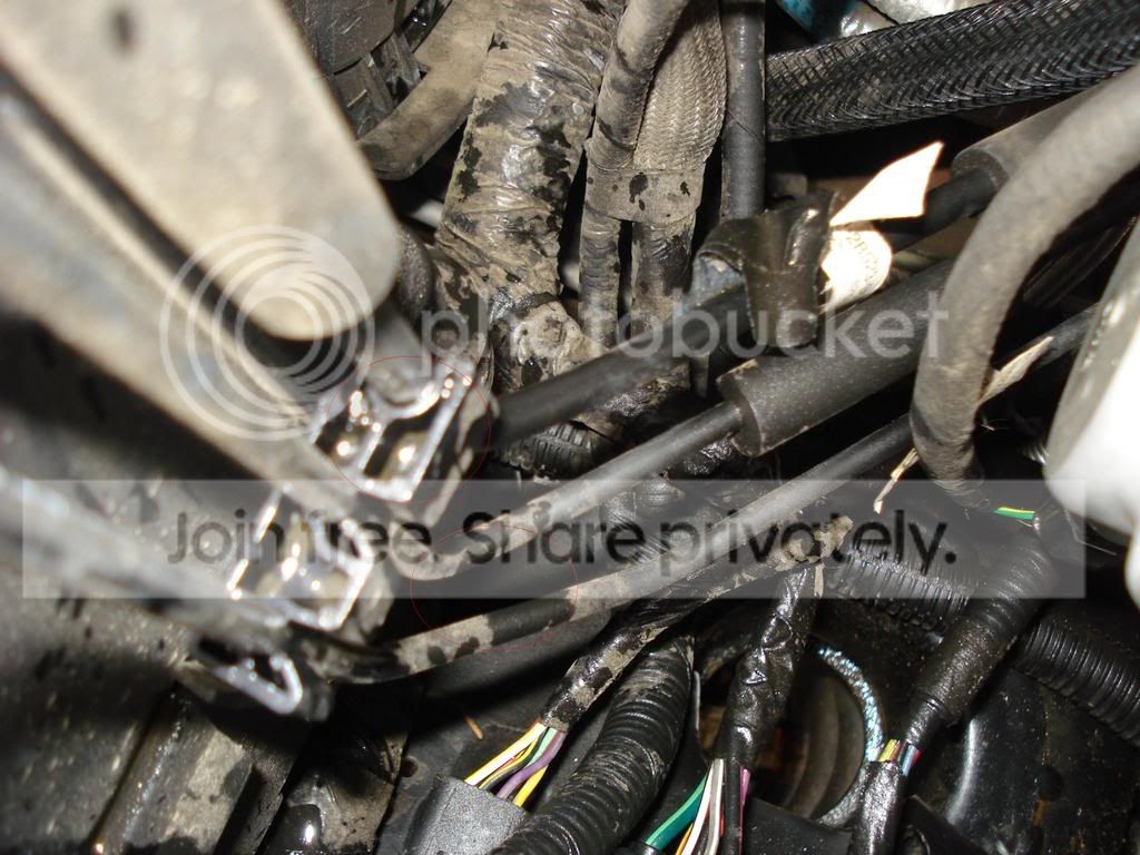

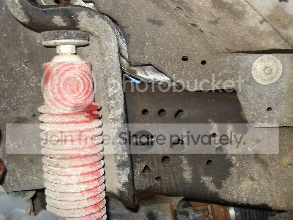

I circled in red where it looks like it is either leaking from or collecting at
