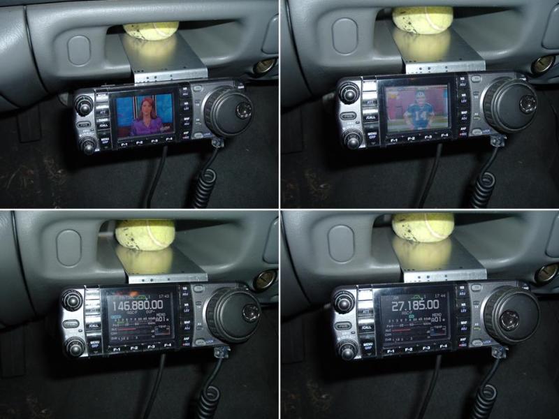

Here's what mine looks like (even though it's not a CB). I sorta stole SpringerPop's idea, but he doesn't have a trailer brake controller (I do, but don't use it -- and I can move the radio head up if I do). I just put it in like that over the weekend, so it may change. But for now it's very functional and very easy to reach with elbow resting on the arm rest. The tennis ball isn't as obvious sitting in the truck as it is in the picture. Still, I may "upgarde" it to a raquetball instead.

is that a mini TV Joe??

No -- multi-band Amateur Radio (Icom IC-7000) with a color LCD display that happens to receive VHF TV (with a mod). Pretty handy.

very cool and clever Joe...

Well, I stole the mount idea from SpringerPop, so the mounting idea credit goes to him. I'm getting a lot of noise (from the PCM I think on VHF, and injector noise on the 7 MHz band), so I'm going to try moving the power lead to the passenger side battery and see if that makes any difference. I picked up one of those audio amplifier wiring kits because it comes with connectors, fuse, and some pretty heavy wiring. That radio draws 20A+ on transmit (puts out 100W on HF), so I need some heavy cabling.

Joe, your hammy would look SICK mounted up there!

Joe,I think this forum would disown you(LOL) if you 'upgraded' to a racquetball. Besides I see a lot more tennis ***** loose on the streets thus should you ever wear this one out just pick one up at the next corner.

Well, I'm not a fan of drilling in to my headliner, and it's not a good angle on that LCD. It washes out pretty badly looking up from a low angle. I had it strapped vertically to the middle seat (just like the pic above) before I separated the head and stuck it there with the tennis ball, and it was very hard to see. The other reason is that I'm lazy -- I would much rather leave my arm on the arm rest while twiddling the *****.
